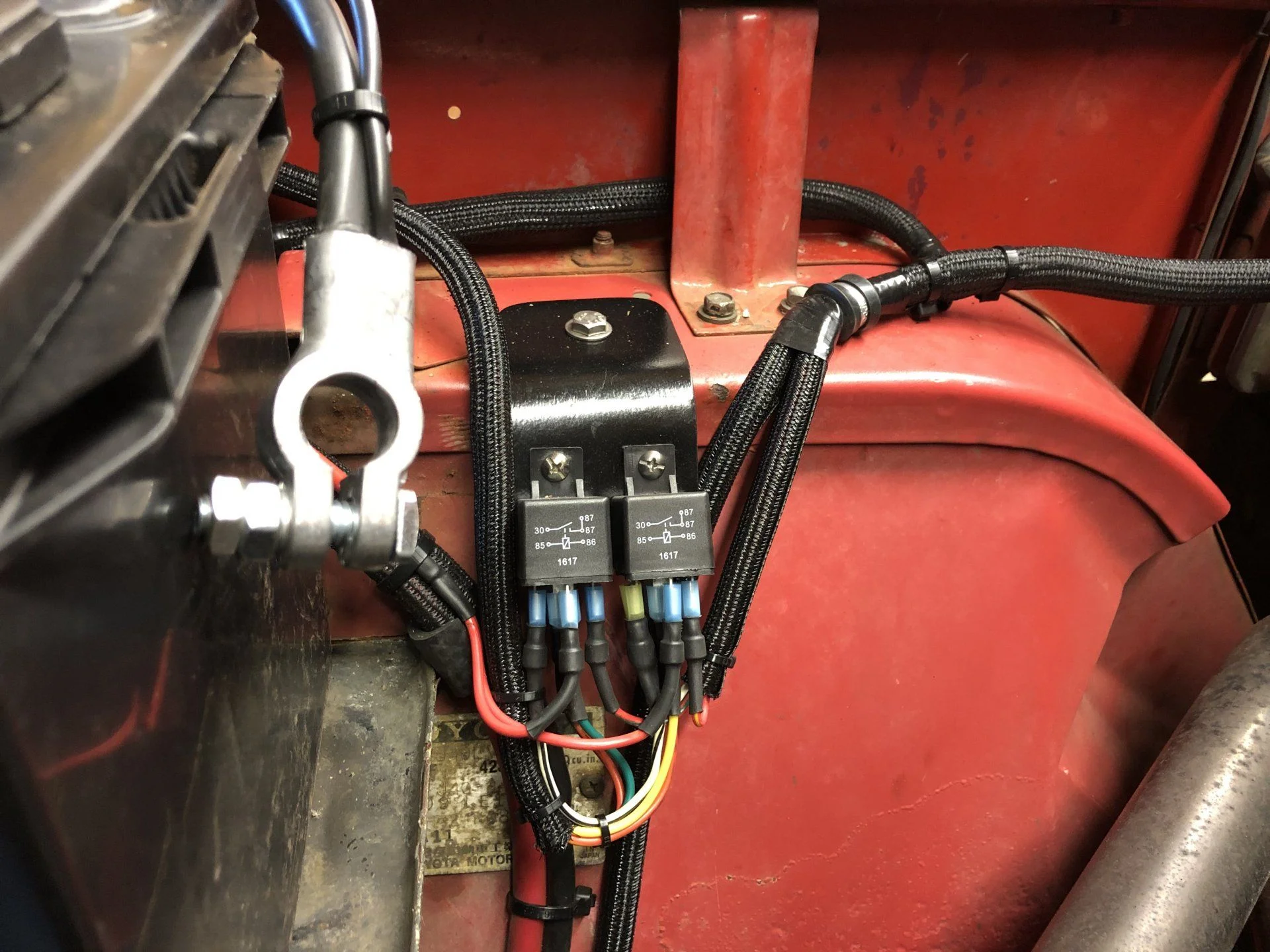

I also prefer halogen on any of my older builds. You just have to have them wired properly to get the maximum output. This is the relay block I put together for my 40. I’m using the same Hella H4 E-codes ive used for years on builds.

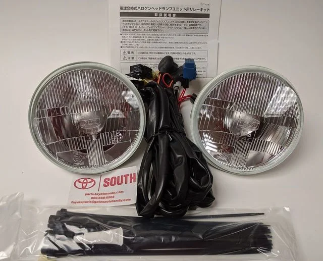

Everyone should buy the OEM H4 light kit/harness for $45 bucks shipped in the US. wiring/relays, harness, housing, bulbs
Absolute steal and from Toyota.
81110-60P70
wow had no idea, that is an incredible deal!
@ratpin where do you get the wire loom? Is it the type with a split down the middle or does it fit after the connections are on? Clean work!
thanks. It has a split seam in it, but it has a 30% or so overlap and IMO its much better than the split plastic loom because it does not have the chance of holding moisture.

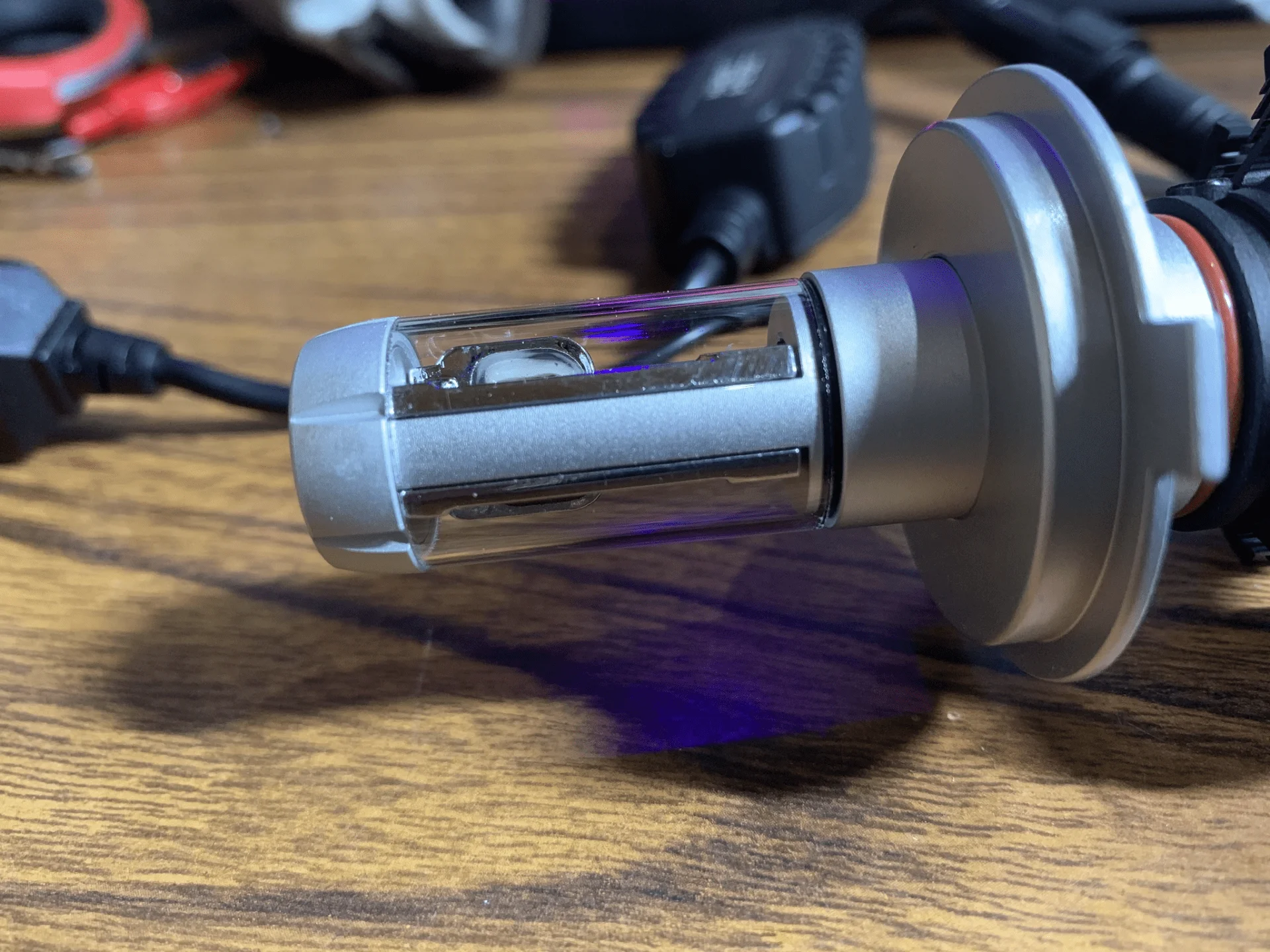

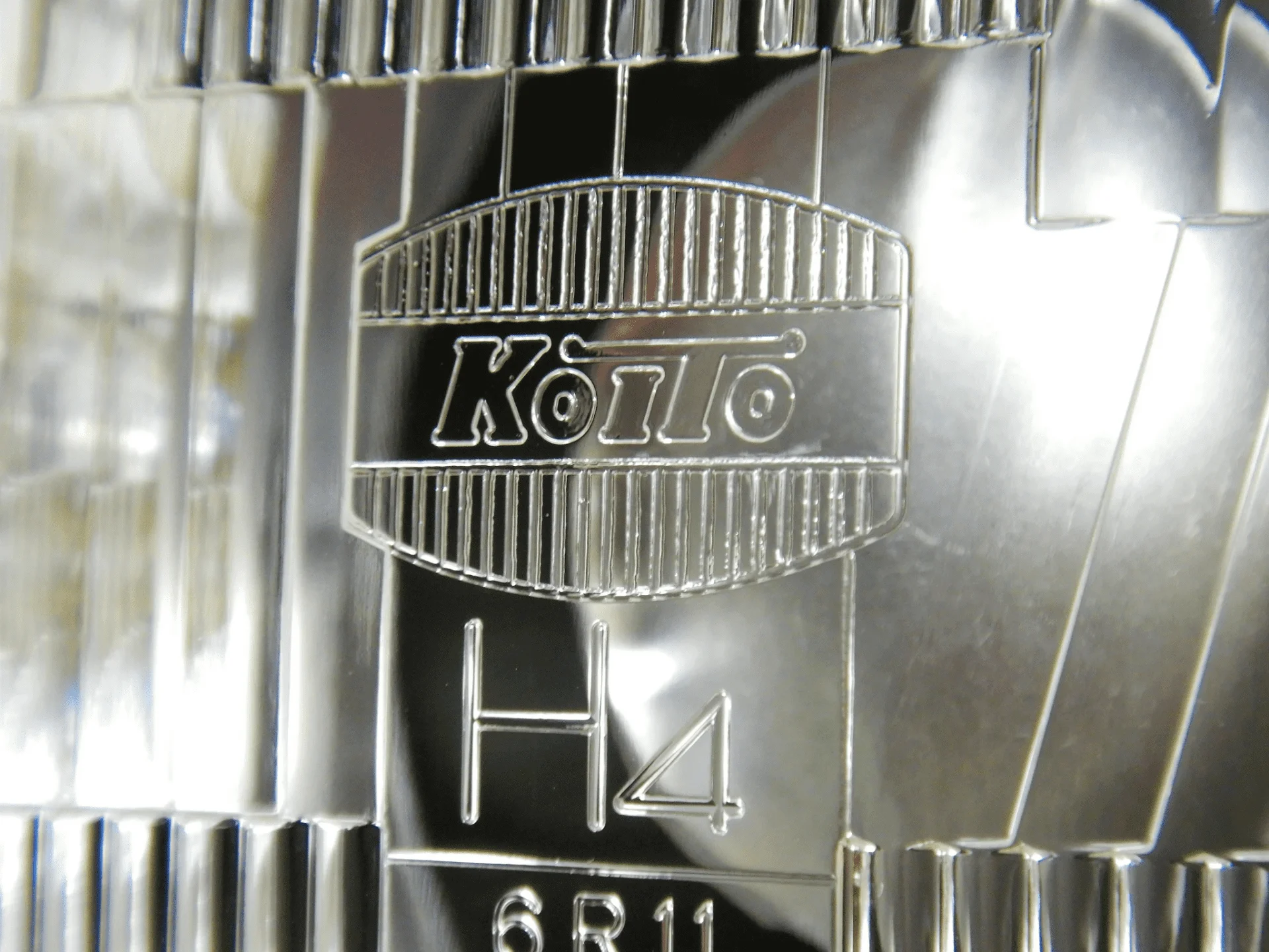

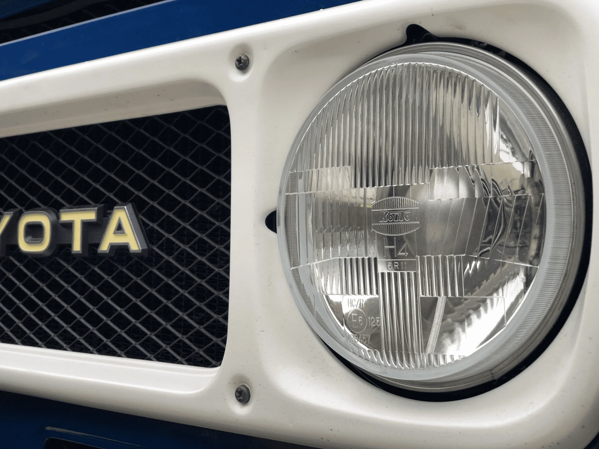

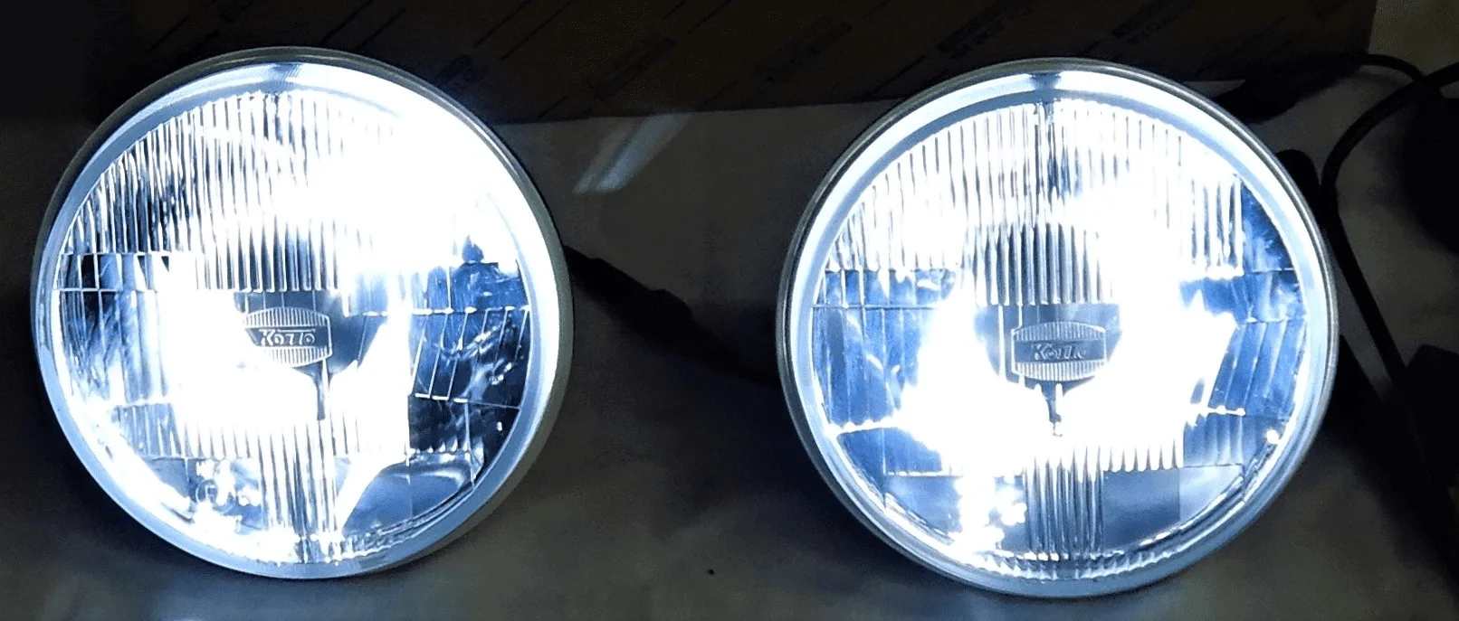

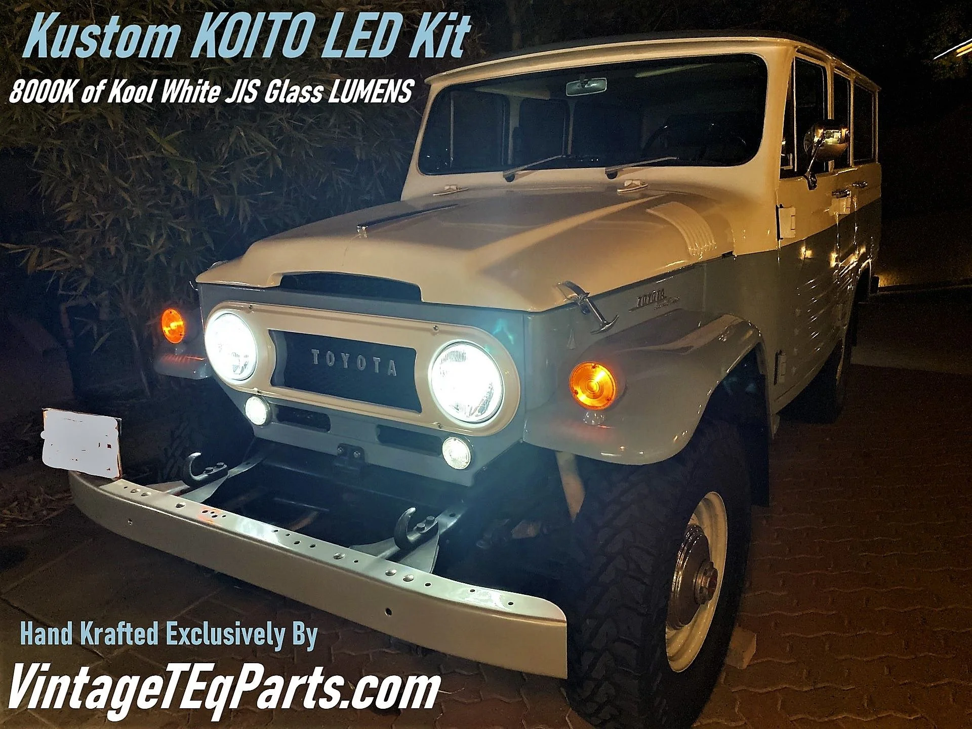

I have taken an different path ....
i took the Top of Line H4 Base Kit on the market today , all 100% JIS glass , no plastic to scratch or fade cloudy over age and time ........
I equipped them with the with highest Performance LED H4 kit i could source globally , the Diodes are encased in O-ring sealed
Glass tubes and are both shock proof and water proof ..........
i wanted to plot a new path and i had a vision , a pipe dream i turned into simply a Bliss reality ........
Exclusively , i hand build and assemble each kit in house , and bench test both high beam and low beam functions ...
i then align the Diodes in Sync with the KOITO Light House Glass JIS Design features ........
All the vertical lines or casting features are not there just for looks or by accident .......
note : there is nothing at super bright LED that comes even close ,,,,,,,,
1 last note , my heat syncs are super compact and fit will with room to spare in the early 40 series solid head light buckets .....
this is my take and my version designed and assembled proudly with indeed some trade craft in my Skunk-Works Lab , to mesh in mechanical harmony , along with a full healthy respect to oncoming traffic......🙂
note; I wear prescription eye wear , and have a mild astigmatism in my left eye , i Have simply NEVER seen the road at night the same since , i then installed the exact H4 Kits in out family Fleet of Tundras and Pre-Runner ........

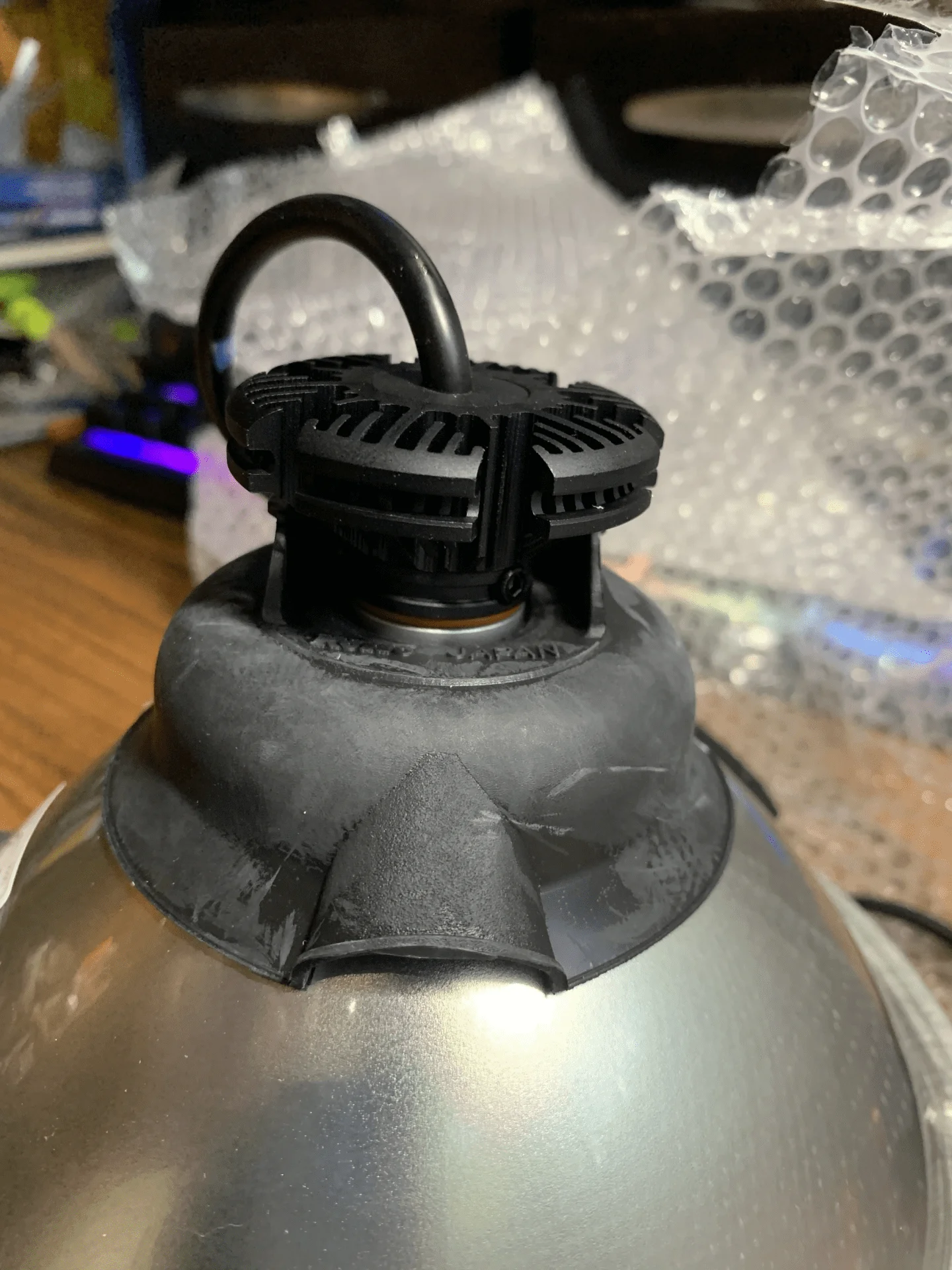

Wanted to see if any of the wiring experts out there could help me. Got some of these led headlights from @Racer65 but can't get them to work. Replacing sealed beam halogens that work just fine. If i install both of the new led lights, neither come on. If I have one of the old lights and one of the new lights installed, the low beams work on the led but not the high beams. I have tested the connectors and have 12.5v at the high and low beam wires when appropriate. Does anyone have any other ideas what might be going on? Thanks in advance
should have went with 100% JIS Glass set up above Kustom Koito's
sounds like a load resister issue or a grounding issue
