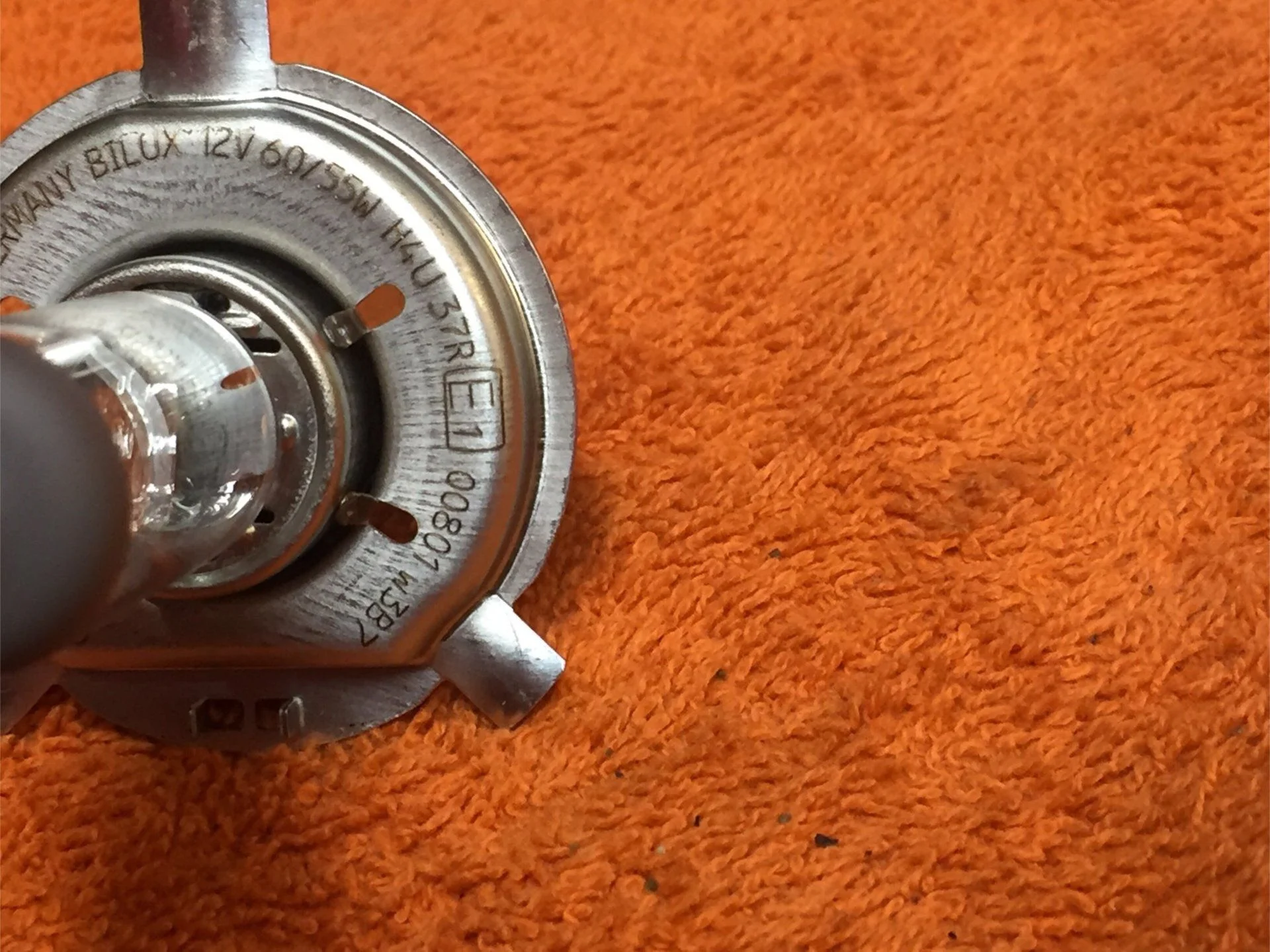

Here’s the bulb that came in my RE’s.

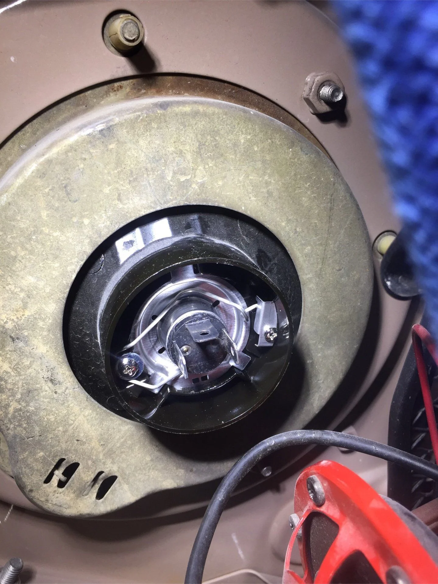

Before removed
Rubber cover

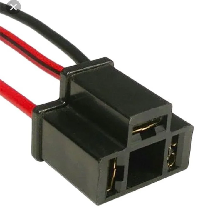

Do the LED’s come with that harness ?
All the ones I see say plug and play ..

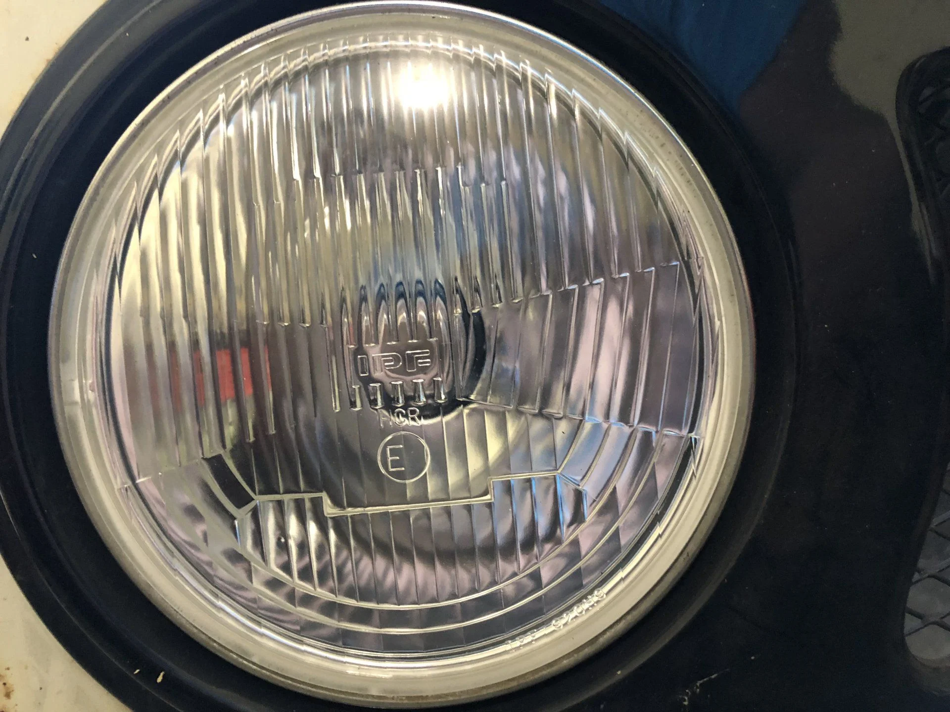

I run the ARB IPF 920H Halogen headlights. I'm also running their aftermarket light harness and relays. I've been really happy with them, particularly over stock performance. They have a pretty crisp upper cut-off so, aimed correctly, you don't blind the folks you're driving behind.

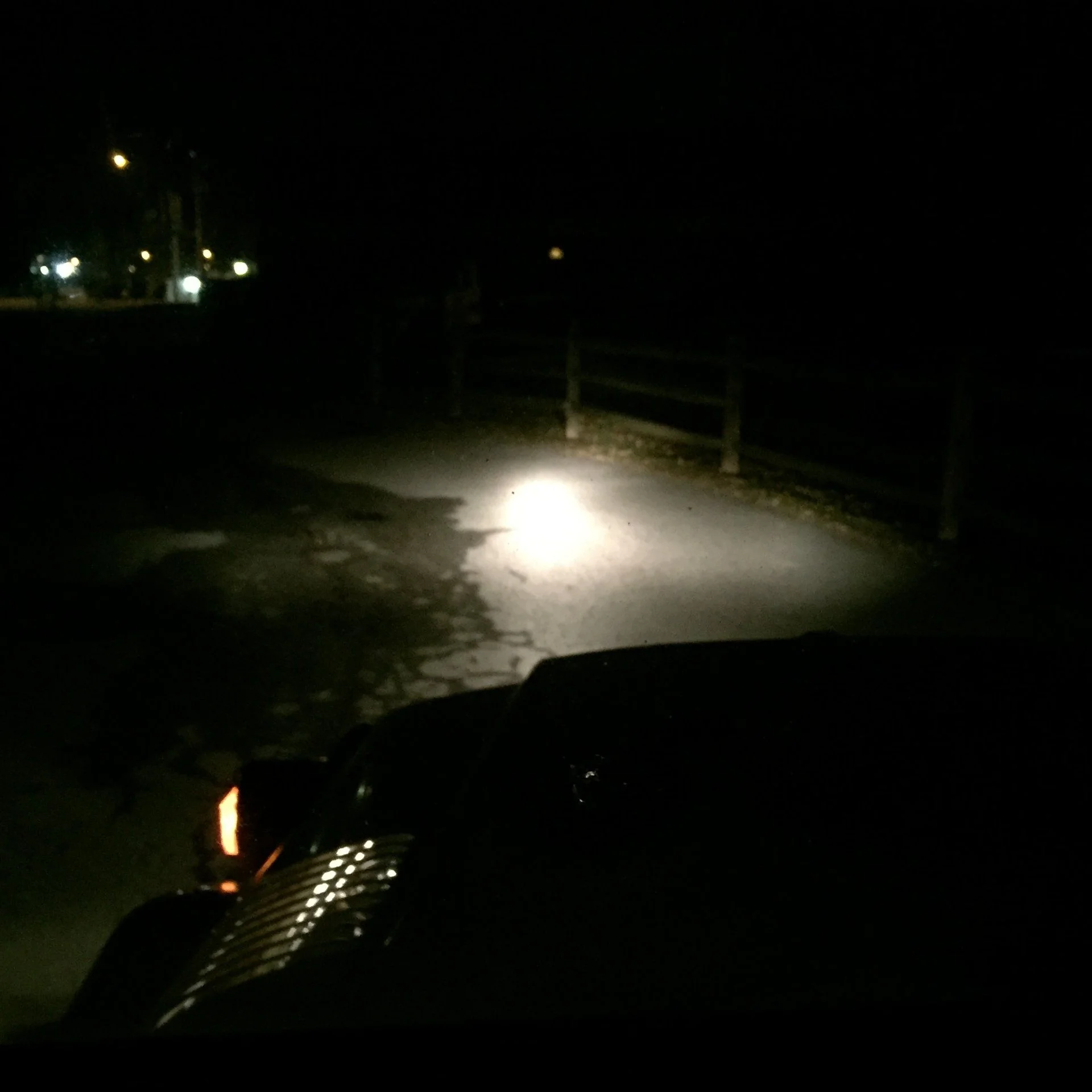

Here's a couple shots with my OEM headlight before upgrade. Note you can barely see the split rail fence about 15ft from the truck:

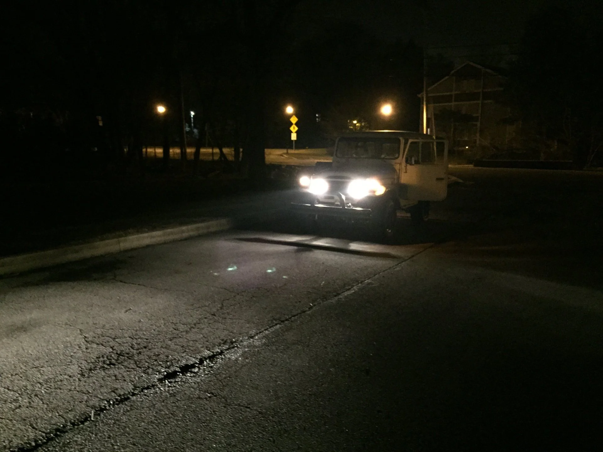

And here is after the IPF upgrade:
Note the split rail fence was farther away in the second shot, PLUS, I illuminated the whole building behind it.
