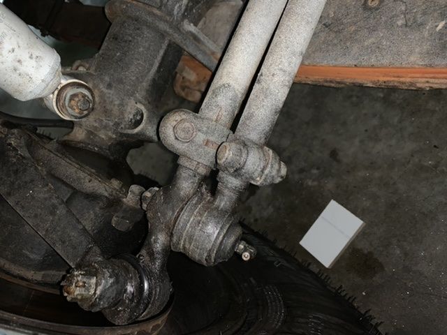

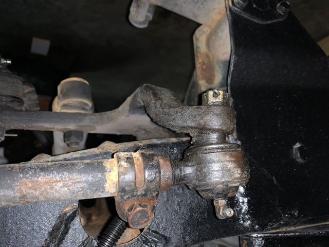

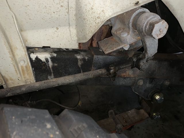

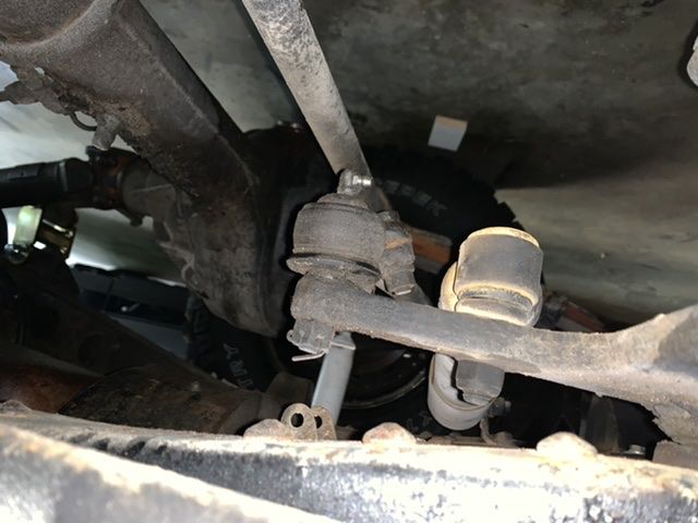

I just changed my oil and was hitting all the lube points while I was at it, and I noticed my drag link coming off of the pitman arm has a slight bend- is this normal or something to swap out immediately? Still learning on my rig, no issues turning or tracking.
I am running a non-stock power steering setup I have yet to identify
You have a mini truck PS box on a custom/homebrew bracket.
Can't really tell if something is bent from the pics. If you could mark up the pics, it would help.
Pj- thank you for the id on the box- the bend is at the joint between the tie rod and end- i will pull the tire to get a better shot of the angle offset
