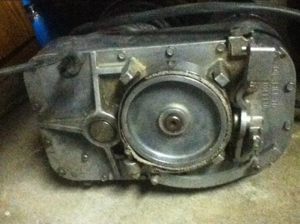

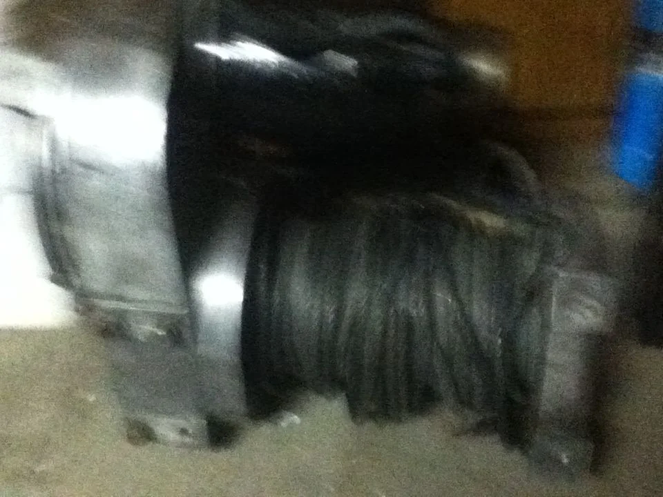

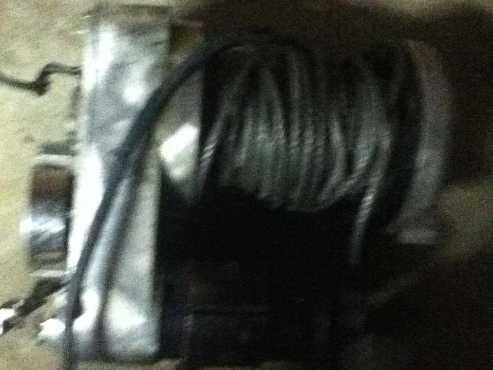

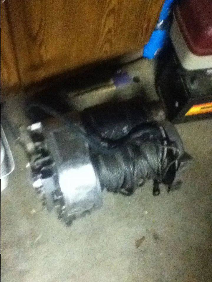

Hopefully this weekend I'll be tearing into this beauty. It's an old belleview winch model 5687. It's in great shape and it runs great with no issues what so ever. Here's some pics for you guys. And for $200 it's not that bad of a deal.
I have pictures to post of the insides. Not that bad but my issue is I hooked it up to a battery and it wouldn't shut off. Is this normal or do I need to get the motor rebuilt o0r is there a secret shut off button I don't know of?
