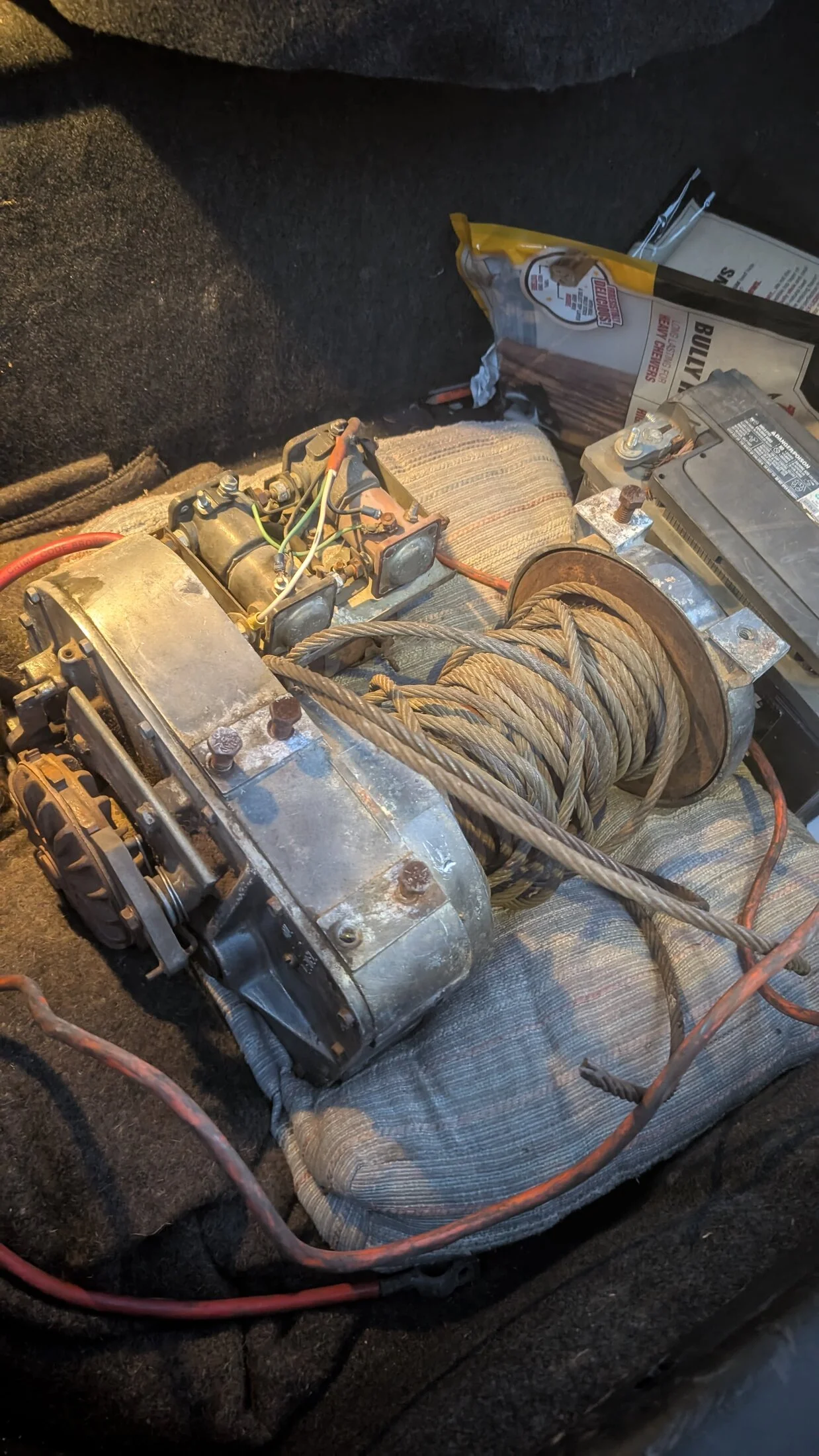

well I got the $950 warn 8200 for $150

I think it's only missing one spring for the free spool lock arm safety catch. works but definitely been used. the cogs on the brake have visual wear. he couldn't get it to work for me but swore it was good. said he had it working before. he had the cables hooked up wrong. it came on a car trailer he bought. as soon as I left I hooked it up correctly with my jumper cables and got it going.

solenoids are shot. i was able to bypass them and get the motor turning both directions. brake seems to be working fine. trying to get that cable off.
id like to strip it down now but i dont even have a bumper for it yet so ill probably stick it under the bench and start looking for the stuff to convert the solenoids.
