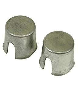

Battery Terminal Shims. Diff Sizes available.
