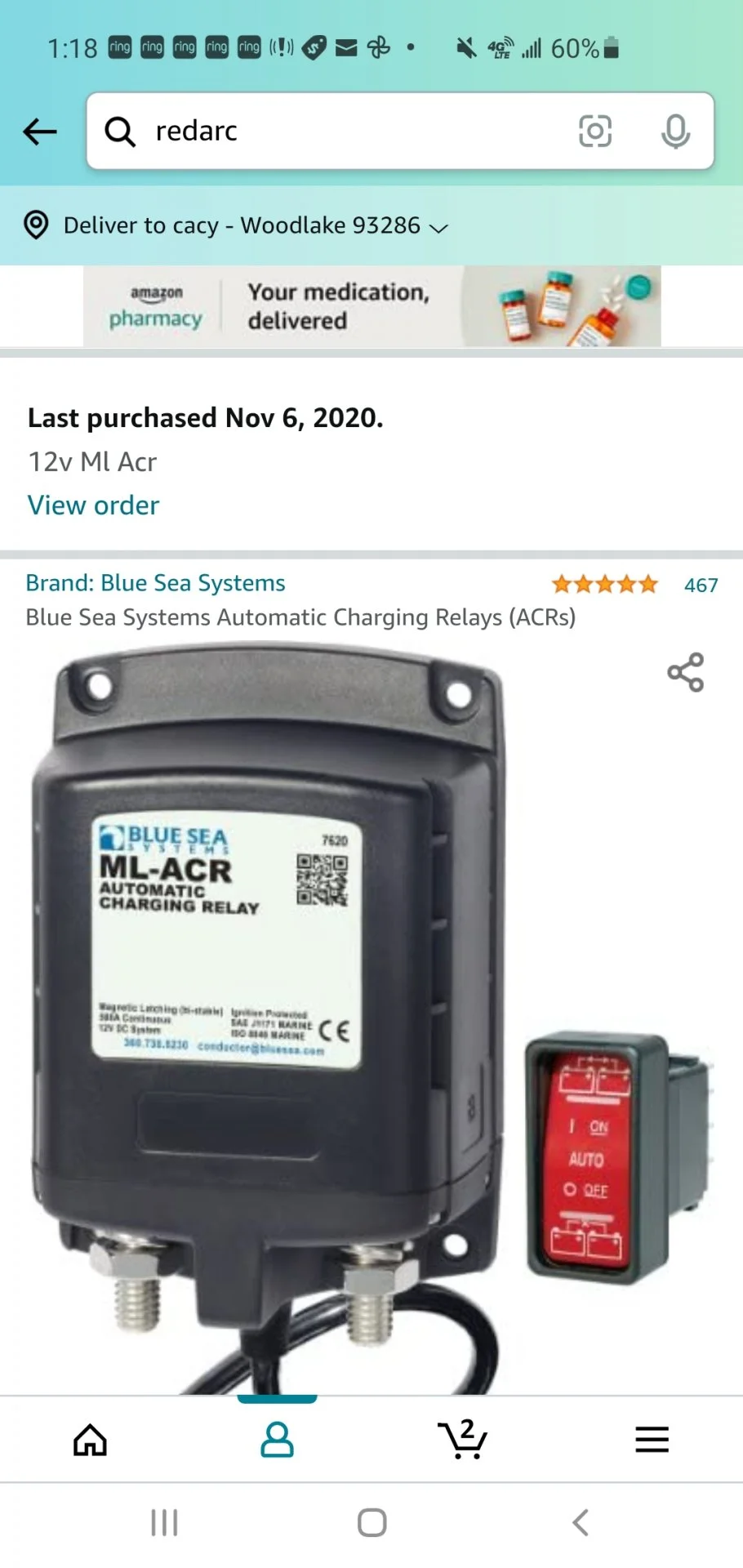

I am working on my dual battery system
I currently have a blue Sea isolator but I think I want to do something different. I was looking at redarc stuff but nor sure what to do. Is there a way to be able to charge with ac/DC and Solar. Basically I want to be able to plug in the vehicle at the house to the wall and charge the batteries and then on the trail charge with alternator and solar. What would be the best way to achieve this. Thanks for the help, this is like speaking a foreign language to me.

I have a similar setup in my 80. I use the blue sea ML-ACR. That allows me to charge my aux battery while I drive. In the rear quarter panel I have a + and - post that I have a fuse block coming off of, an inverter, and I have attached Noco ring terminals. That way all I do is connect the Noco charger with the quick connect. The ML-ARC will then sense the higher voltage on your aux battery and then start to charge your main battery as well. The CTEK might do like the NOCO charger in that once you plug it in then it starts charging based on how it was last set. Which is nice because you just plug it in and go.
If I wanted to add solar I'd just wire a solar controller to the main post in the back and then attach the panels to the controller.
Since you've got the ML-ACR you're already most of the way there. The Redarc will probably only really benefit charging the aux battery with better charging algorithms when you're driving. A decent solar controller and a charger like a CTEK or a NOCO would basically get you the same charging algorithms while you're parked.

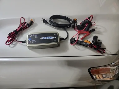

The CTEK is a MULTI US 7002 but oops I guess I made it sound like I permanently wired the CTEK. I'm not that talented LOL. I just have the CTEK available for charging either battery via the battery clamps. I can also use it as a supply for something that requires a higher amperage 12V cigarrette lighter type of power source. I can also use it for the other car if need be. Sorry for causing confusion.
It's cool. Can you hook it to one battery and it will charge both or do you have to charge each battery
Each battery charges separately for 2 reasons: the dinky CTEK doesn't have the current capability and, in my case, the batteries are of 2 different chemistries necessitating different settings on the CTEK.
