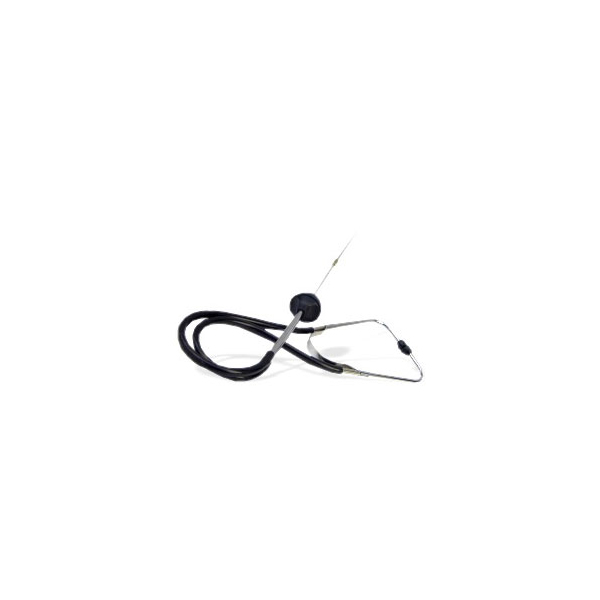

You could pick up a cheap stethoscope like the one below. They are a valuable tool in troubleshooting loud bearings, vacuum leaks, injector issues, etc.
