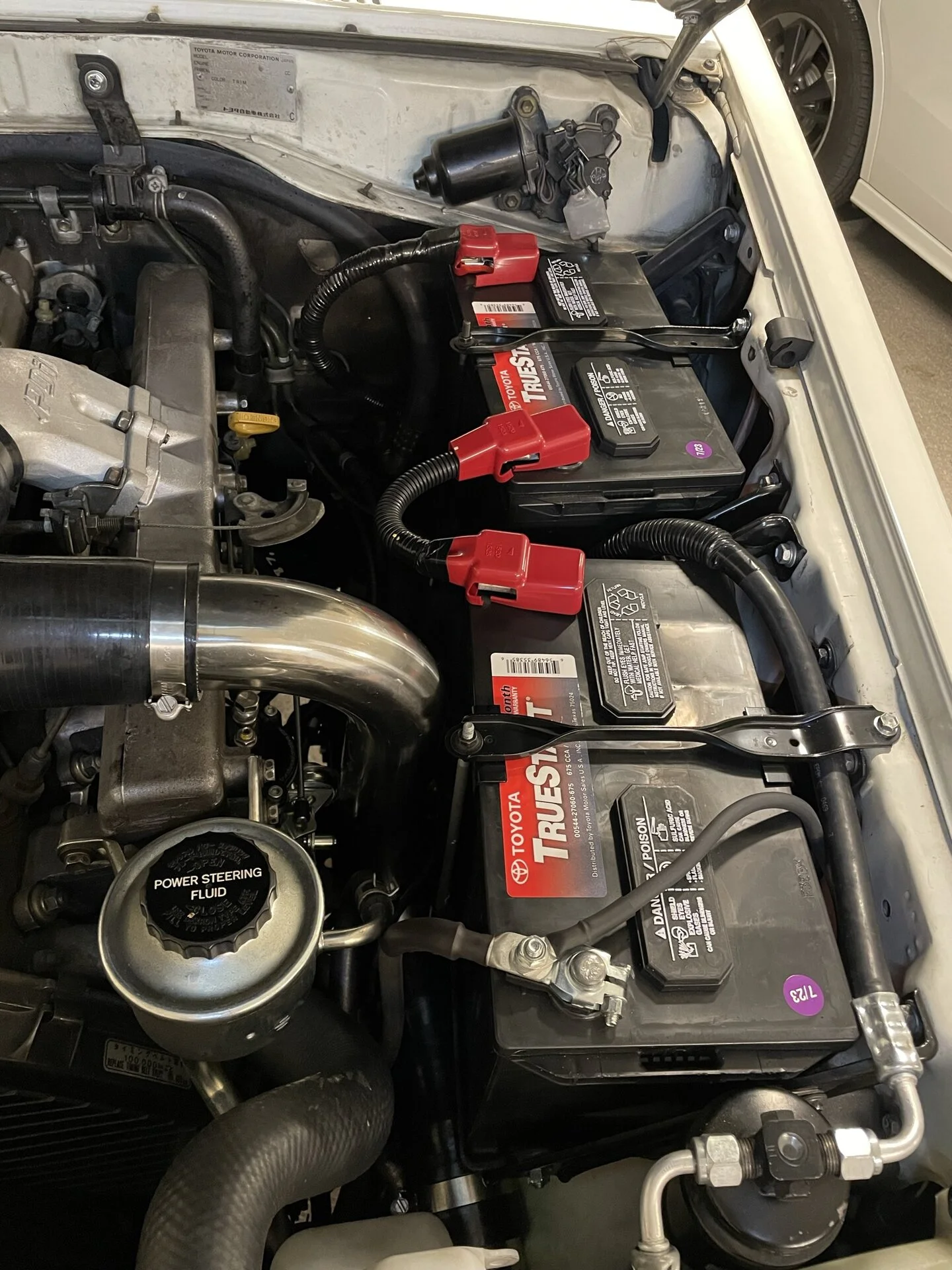

I'm sure this is simple question but I would like to make some new cables for our 24V BJ45. What is the best gauge cable (2 or maybe 4 AWG?) and anyone have recommendations for terminals?
I bought a hydraulic lug crimper off Amazon. Make sure to get the same brand lugs as the crimper, so they match.
0 gauge or 2 gauge is great. I think Toyota OEM is 2 or 4 gage.
