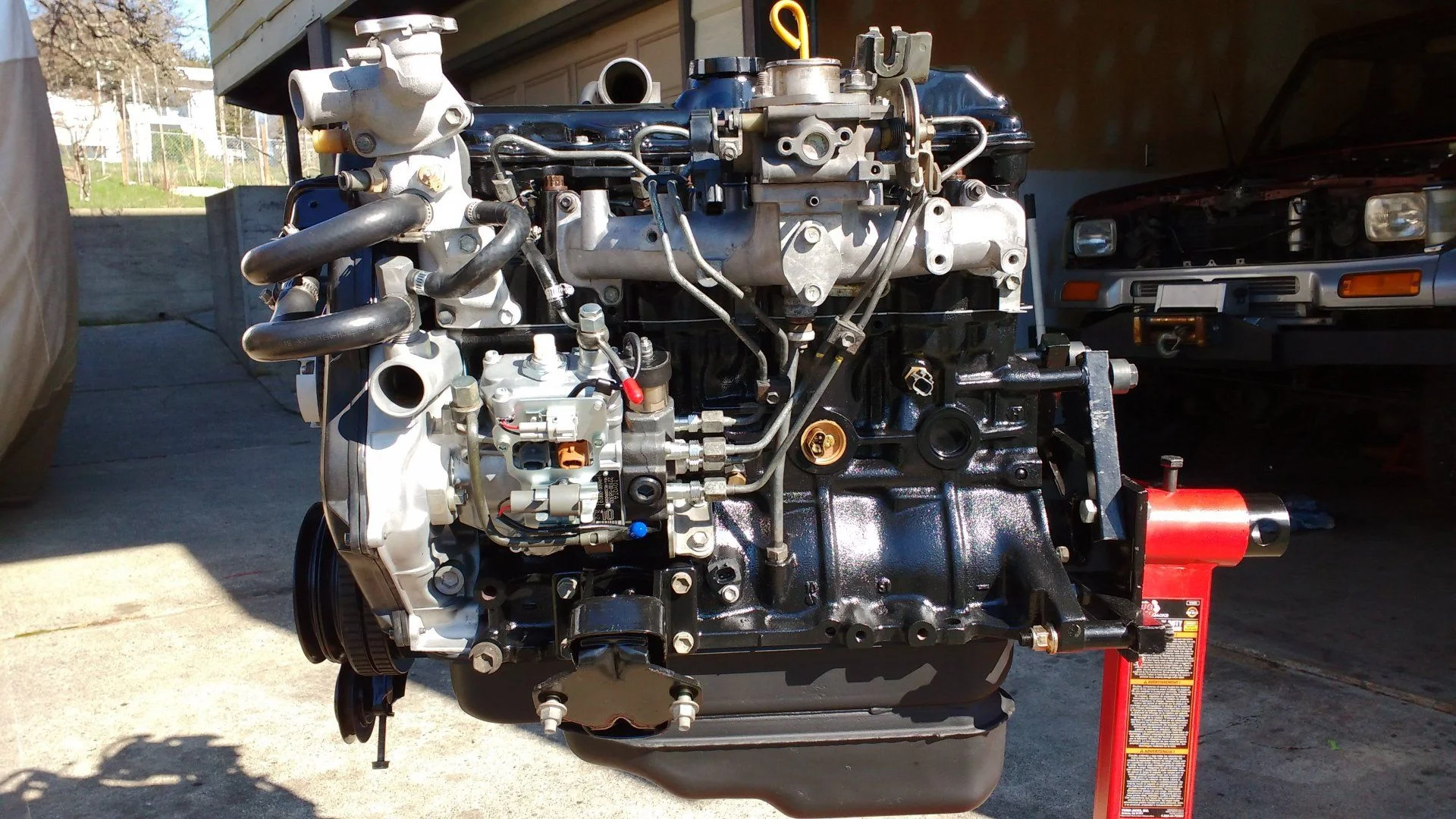

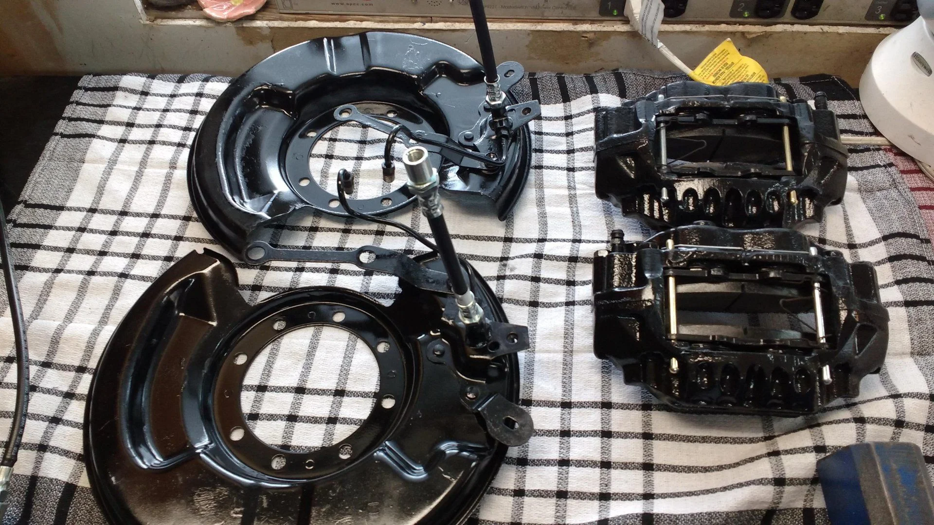

I've had fantastic luck with a Engine Enamel I buy from Lordco. I think it might have been Dupli-color. I've been using it on everything from my engine to brake calipers. Had no rust come through. Brake fluid, ATF, engine oil etc. does not seem to upset it in the least. No rust coming through. I've never used anything so good.
My engine and calipers still look like this after up to three years later (examples I could quickly come up with).
Some of these parts were just cleaned and painted. Others were sand blasted first. Nothing was primed. Smaller items I did heat cure in an oven. I'll try to confirm the exact paint...
Your oil pan is weird lookin man. :lol:
That paint sounds better than anything I've tried lately. I'll have to check it out.
Haha, weird oil pan is par for the course for the 2LTE I guess...lol.
I'll try to confirm exactly what the product was. One thing, is heat curing is the only way to have it harden properly quickly. Otherwise it needs about a week to cure properly at room temp.
It really does have an 'enamel' hardness to it once cured though. I've used a lot of different products over the years, and this one is a real winner.
