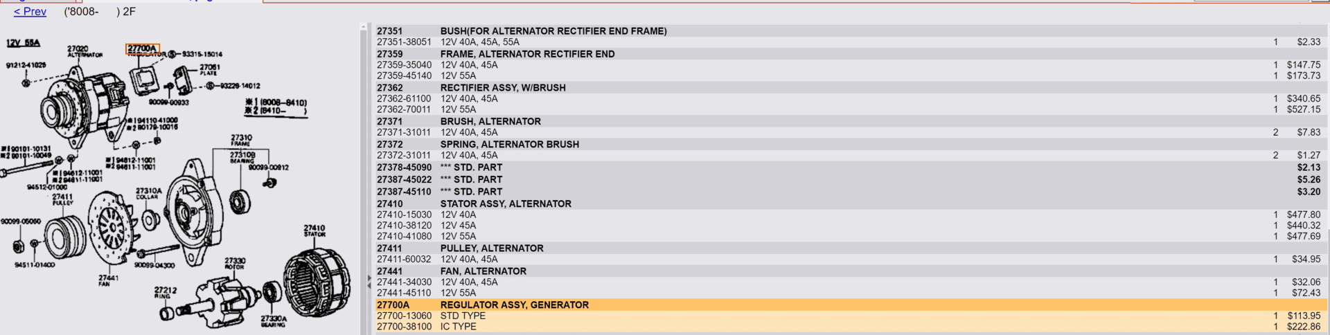

So the battery was bad but under warranty. After replacing the battery the alternator was checked and the voltage regulator checked bad. Should I just have the whole alternator rebuilt?
On your 60? The voltage regulator is removable, even though it's "internally regulated". From toyota, it's expensive, might as well just get a reman alternator:
