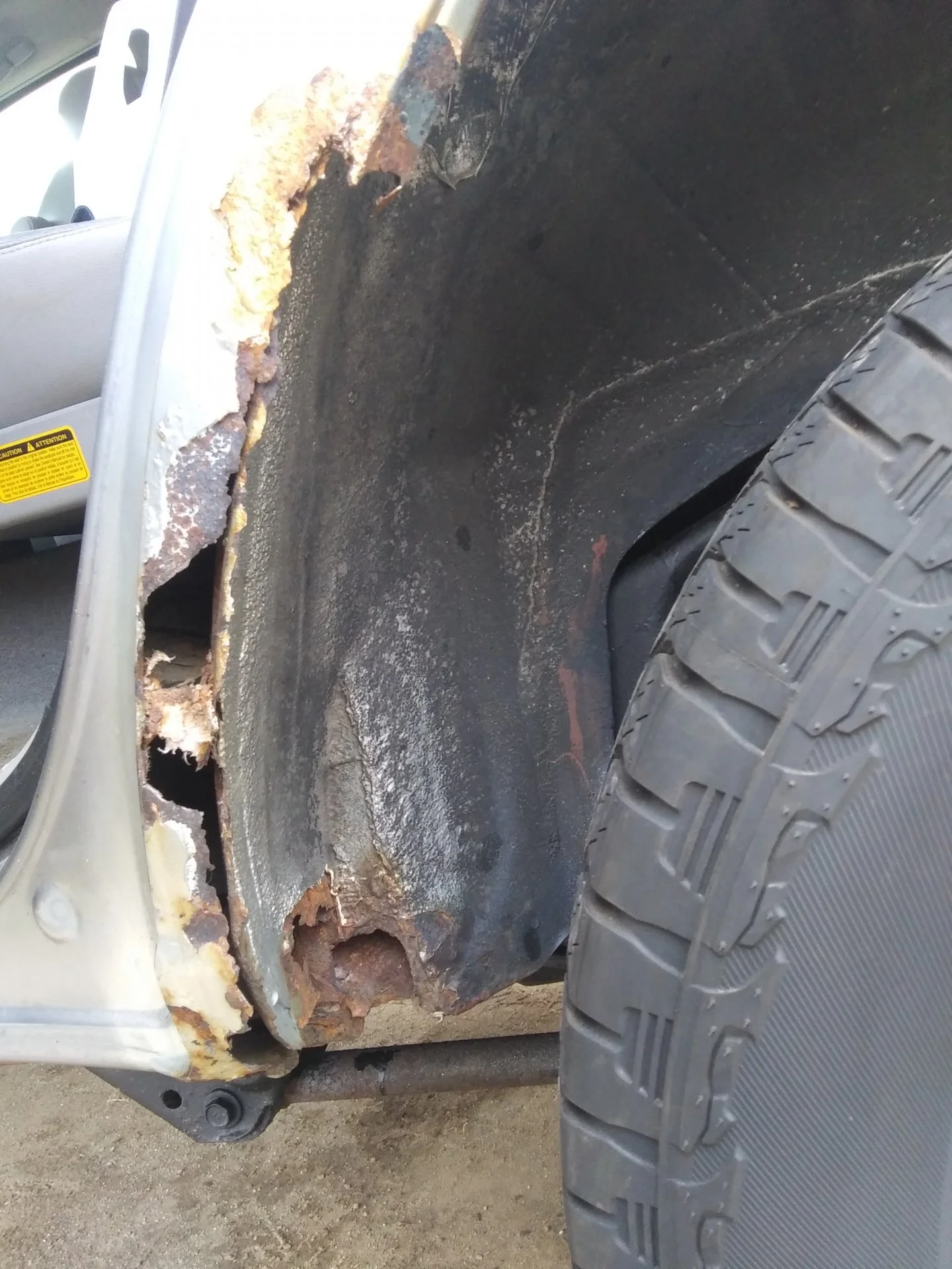

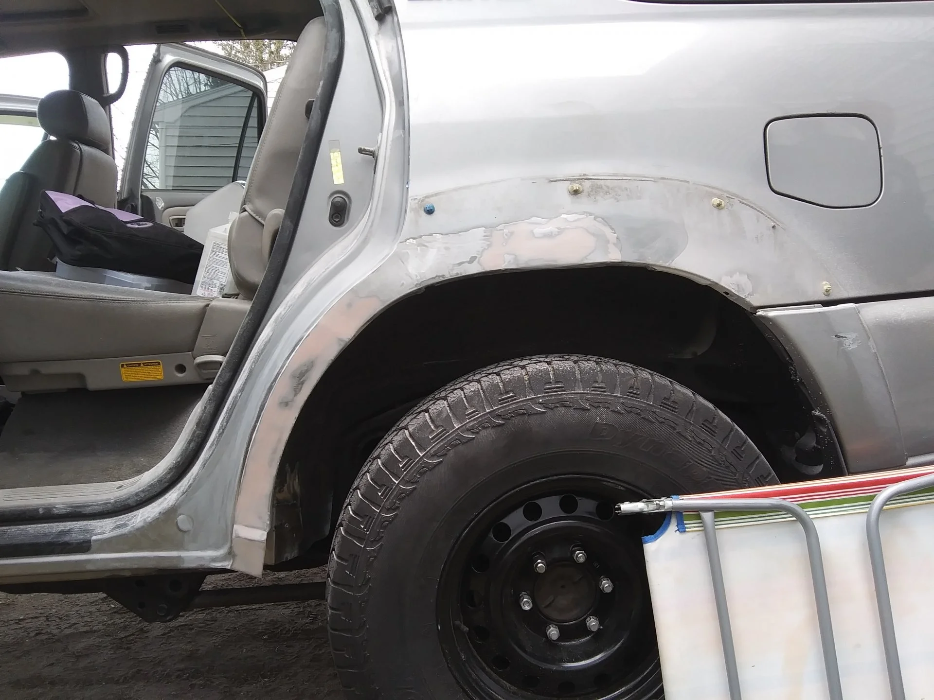

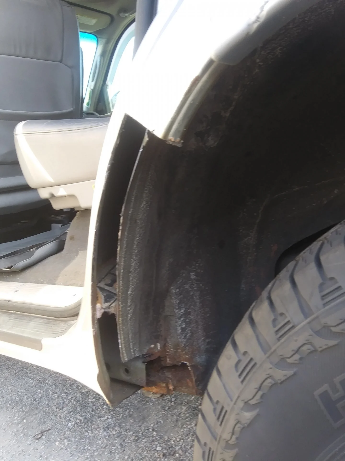

New England salt & beach front driving have been taking a toll on my body panels. Mainly the wheel wells and dog legs.
Figured i'd put the hillbilly hat on and attempt to repair them.

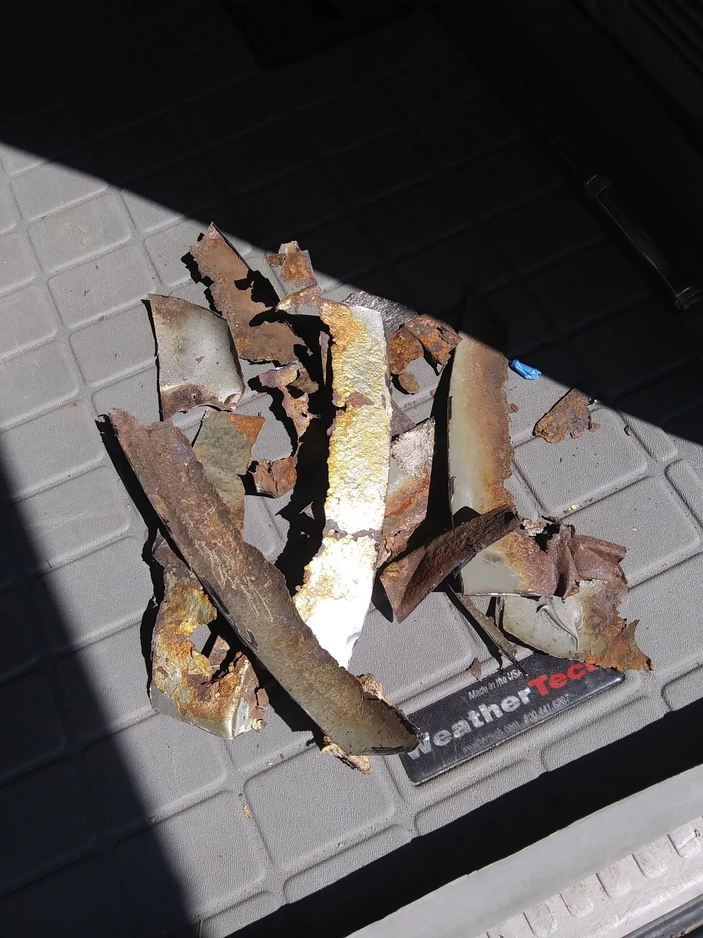

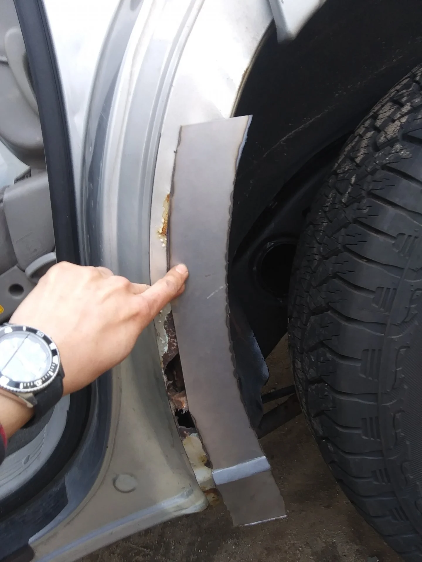

Cut out the rotted area

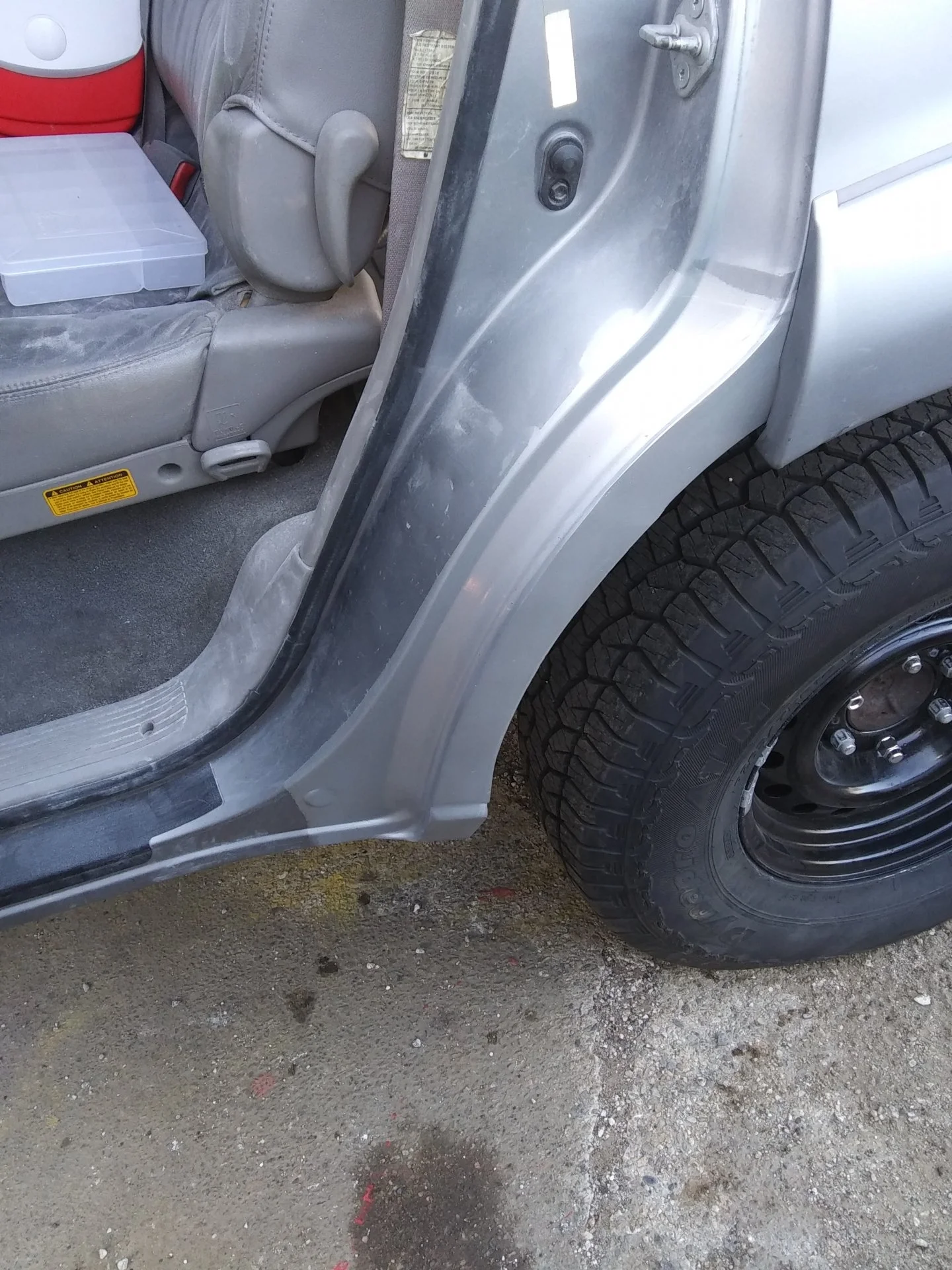

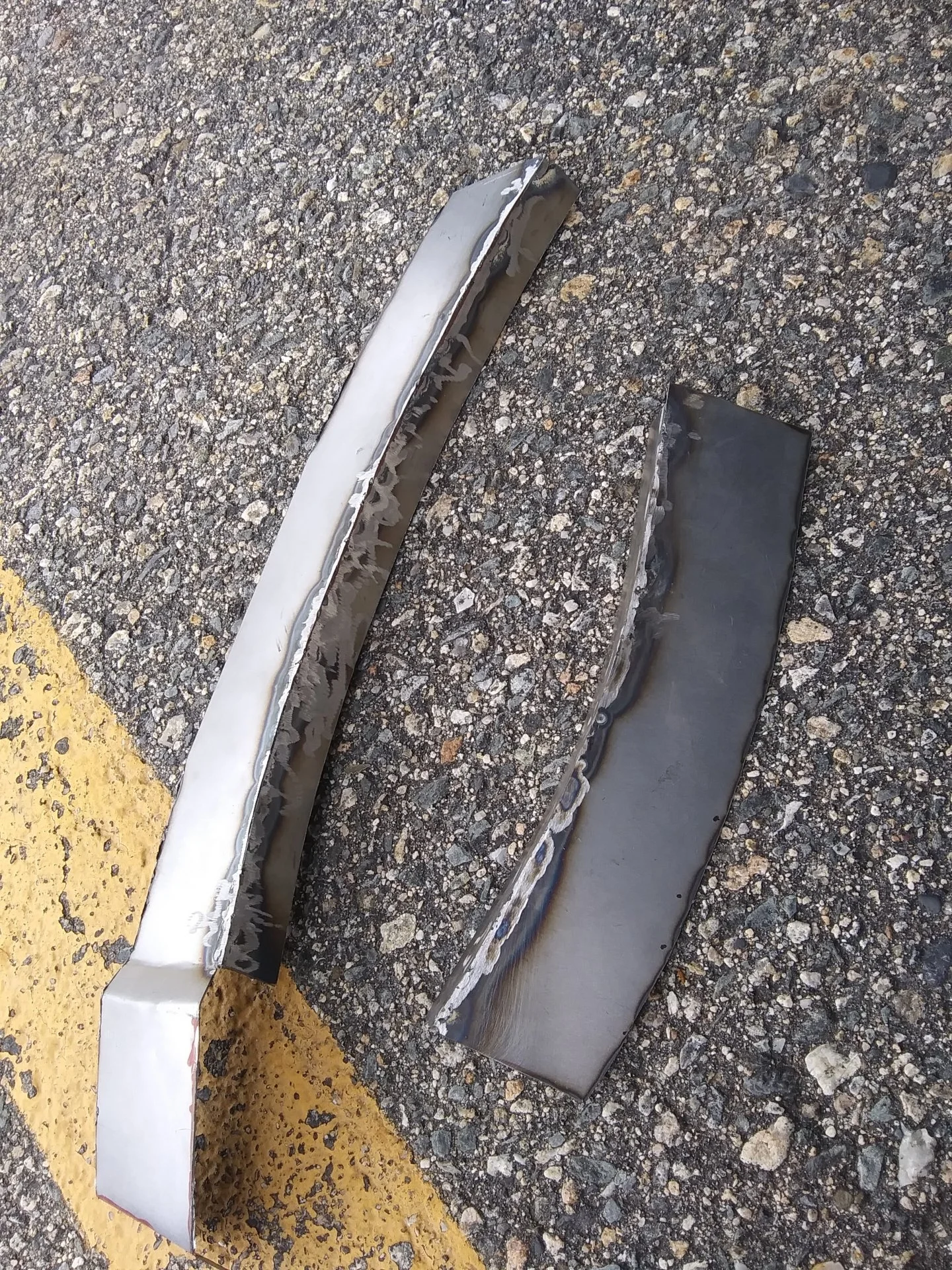

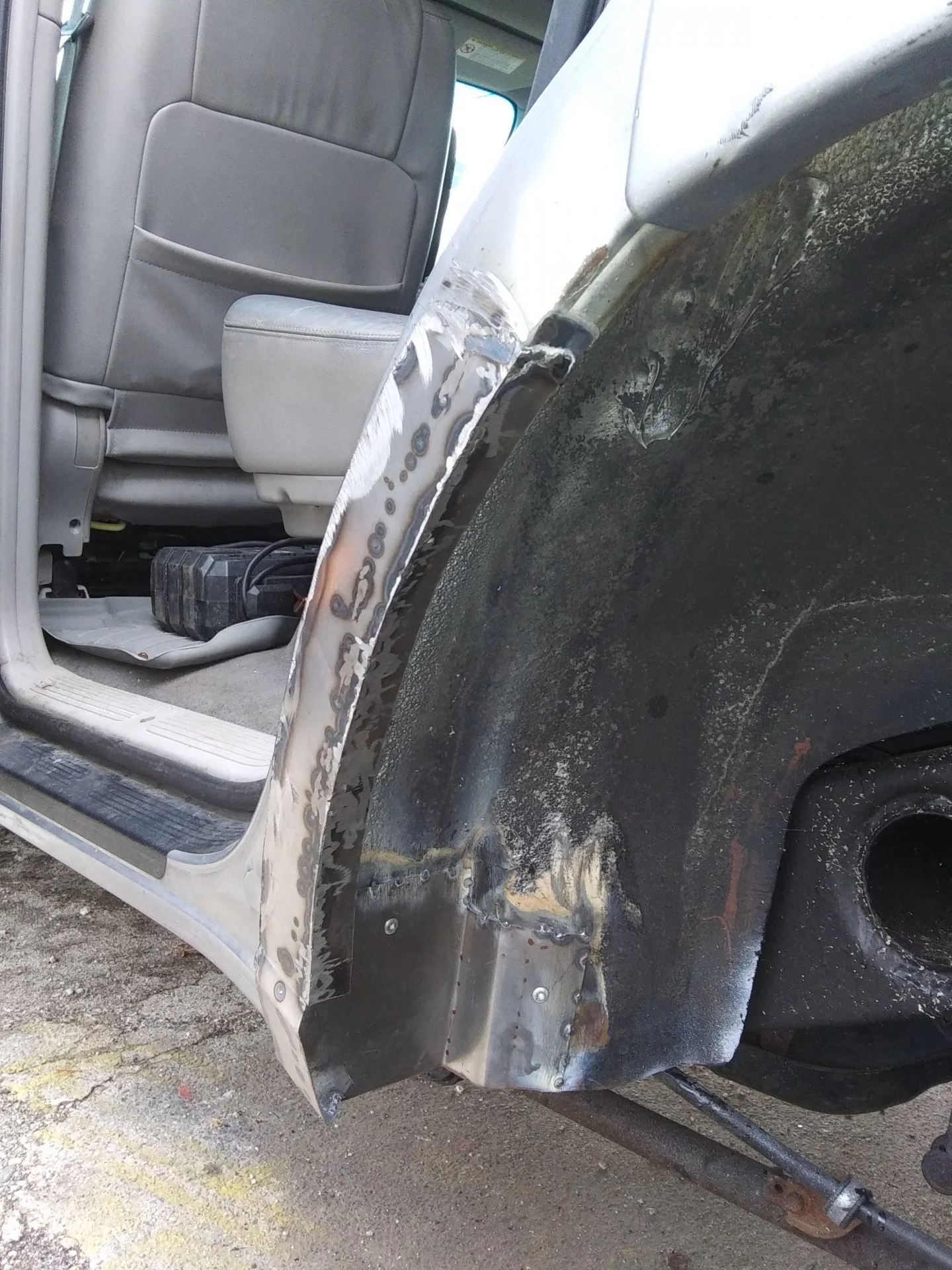

Traced out, cut and welded replacement panels using 22 gauge steel. Using a vise to bend to shape.
Welded in, grinded down booger welds

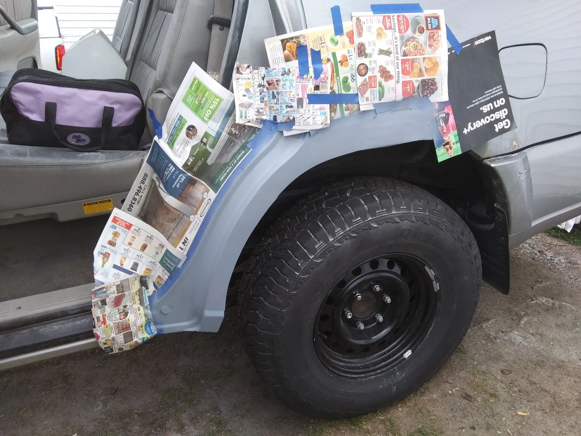

Body filler to shape, prime & paint

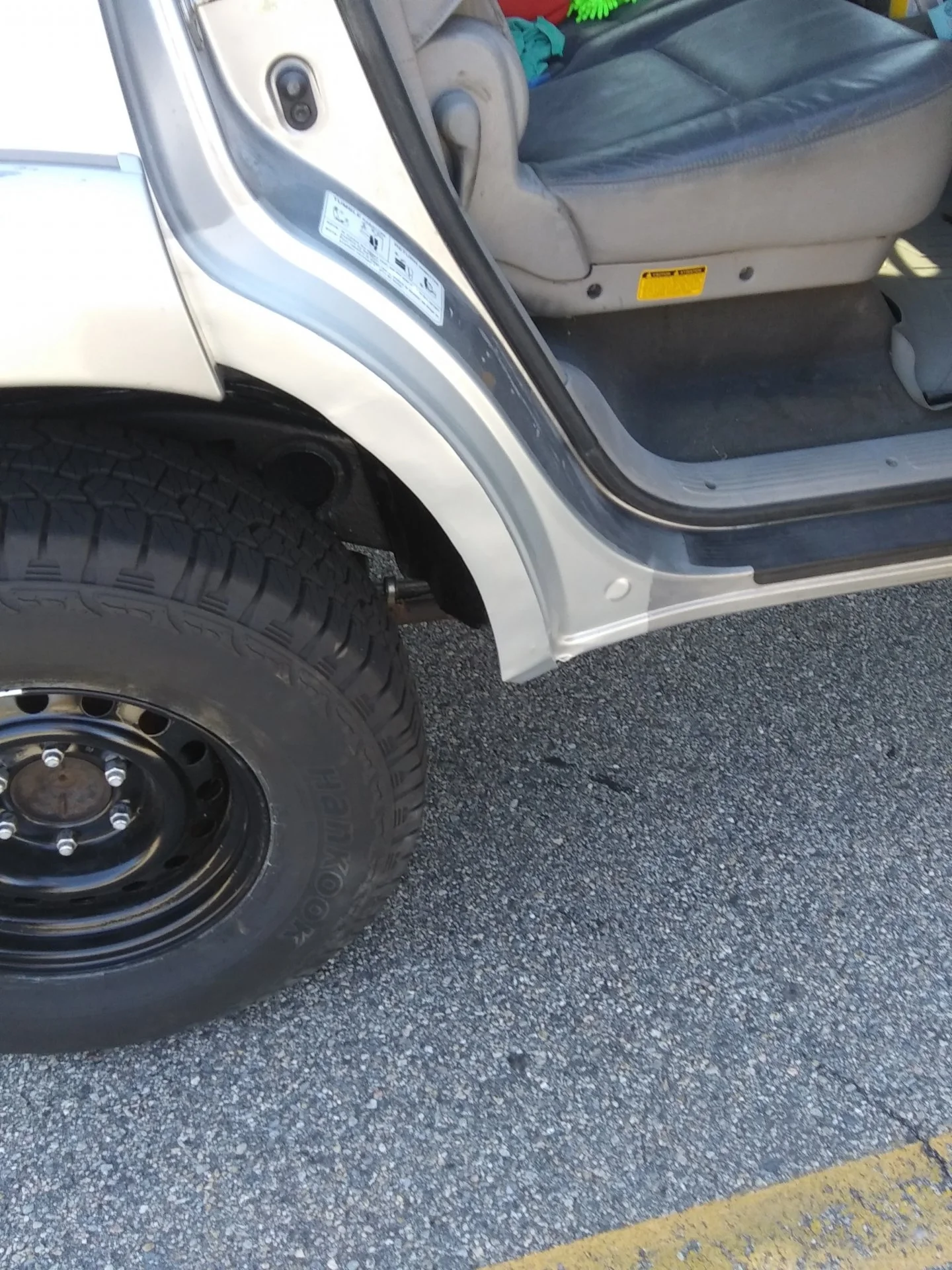

Finished product.
Good ole' roofing tar seam sealer. No auto parts store had the real stuff so I had to improvise..
I'm by no means a professional auto body tech and its not perfect but its better than letting the truck rot away.
