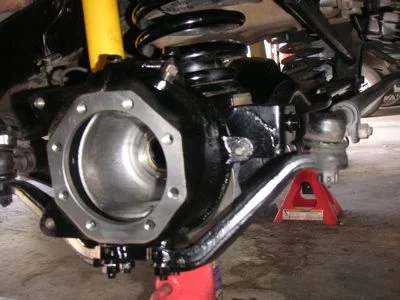

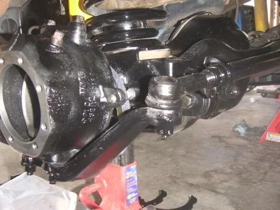

Well the Birf party was fun to bad some of you missed it. Tim and John showed up bright and early at 9:00am and we started soon after. we stoped for lunch and to go get more parts and next think we knew it was 7:00 and we were just finishing up one side each. The prob with a birf party is too much talking and looking lol. if some one said anythign we all stoped and looked. I wanna thank Tim and John though for help doing my first birf job it was nice to have the help and reasurence.

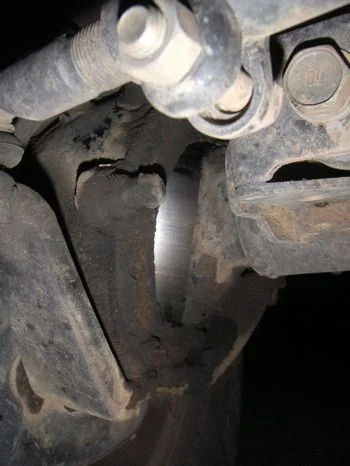

No sense in rushing things so after about 9 months since I repacked the drivers side birf with Mike and Jon I finally got around to doing the other birf - took me 9hrs :o .
These are pretty tough trucks - almost no moly was left in the knuckle, only a small amount of diff fluid was keeping the joint lubed but after breaking it all apart I could not find any problems with the Birf at all.
