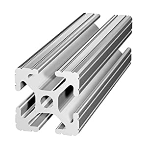

My suggestion is do some type of cross bar and put a tower on the other side. Even a piece of wood would work, but better yet how about an aluminum extrusion like this: Amazon.com: 80/20 10 SERIES 1010 1" X 1" T-SLOTTED EXTRUSION x 48": Industrial & Scientific
4 towers, a couple extrusions, drill 4 holes and 4 nuts & bolts later you've got a rack that would support an awning, haul a kayak, or carry a couple 2x4's home from the Depot. you wouldn't want to dance on it, but it'd get the job done. hth. :beer:
edit: I made a whole rack out of that stuff once, for about $150 in material costs (not including towers). The 1" extrusions flex a little but without a direct load they did just fine.
