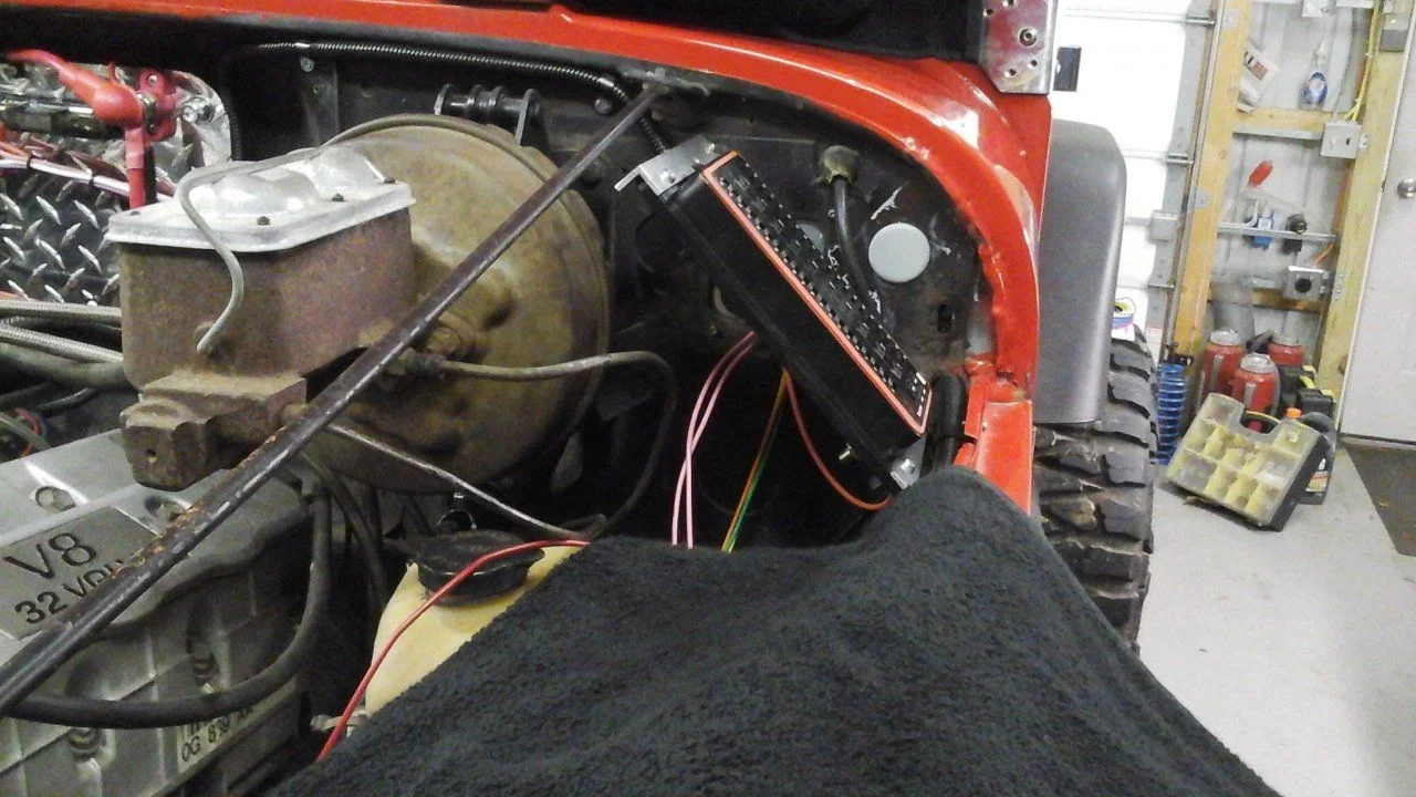

Anyone have a picture of one mounted in a 94 80? I am having a little bit of trouble finding a suitable location to mount mine.
Working on the same thing for my 96. Let me know if you come up with anything.

Hey I think he is still making these. Think it was like $95 shipped CONUS or something like that. A killer price. My CJ is getting one 10 and another 5 relay panel. Every chassis circuit except for the fan is running through them so now thinking about how they'll be sealed in the back
How do you seal terminals with more than 1 wire? I'm thinking about relays that are switched by the same source like ignition. Is there another bus distributing ignition to each relay or are you jumping them from relay to relay? Hoping there's a seal that can accommodate two wires out there... Your experience is much appreciated!!!
