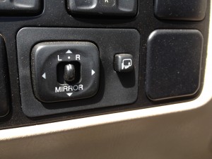

another option is trying to hunt down one of these mirror controls and using it as a stealth light switch.

Or use the LX mirror switch and use the "mirror fold" button for the LED lights.

Only the blanks right and left of radio and the blanks in the area of mirror switch can be used
