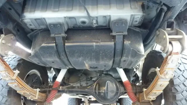

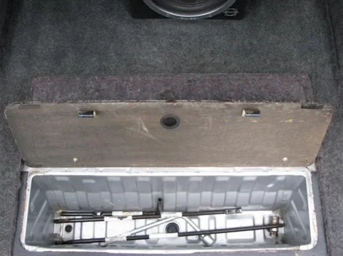

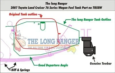

so by looking into long range tanks 76 long range tanks will not fit (by my research) because of the fancy compartment located in the floor as shown in this picture.
Sometimes i wish I had the poverty pack version.
Here are some 77 shots
here is a shot explaining why I don't think it can work. Kind of a bummer.

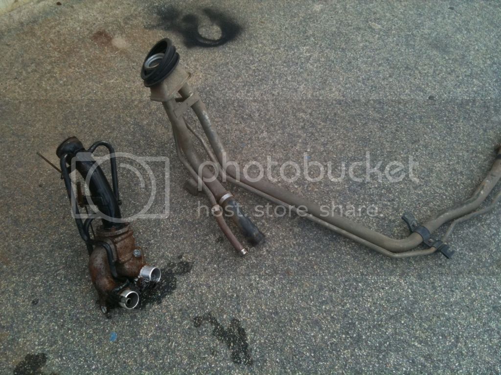

anyone have the part number for the dual filler for the 80/100 series?
I have a quick question for you foreal...how down past the bottom of the frame does the stock tank sit? Or if anybody knows how far down past the frame a stock 79 series sub tank sits. I planning on using a bj74 tank back there but it drops below the frame rail a few inches...i really don't like that but I might have to live with it.
They work different , the 80 has a pull lever and flap to switch between the front and back , the 105 has two fill holes (front tank & back tank) but in the same filler neck
So I presume different part numbers , I have a mate who fitted a 80 filler to his 105 though

I have both fillers but no numbers ,
can't check Toyotadiy?
I'll have to post some pic of each up then.

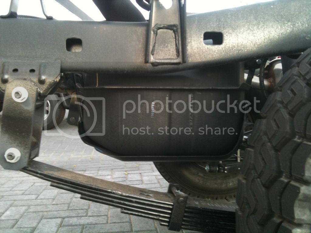

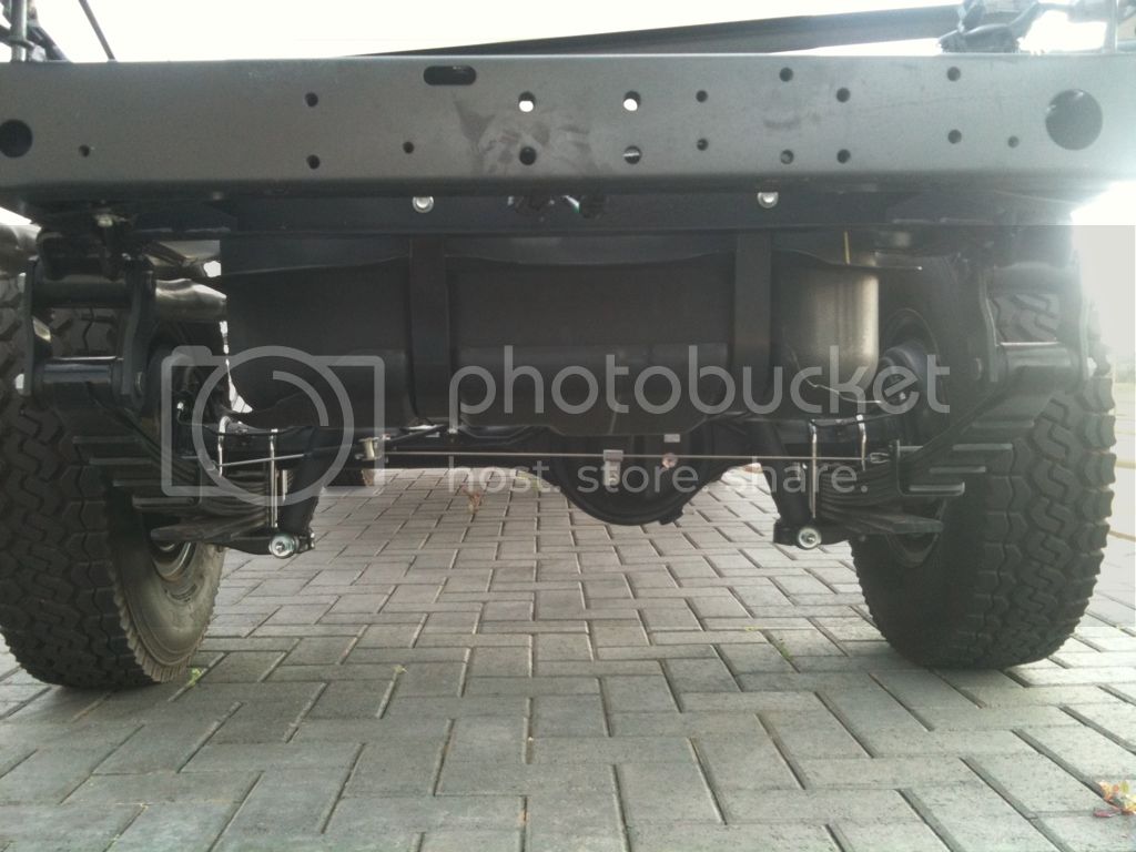

are you really going to scrape a fuel tank? i think i am more likely going to drag a bumper.
I don't know the measurements.
This is a 79 series sub tank
thanks for the pictures mate...thats exactly what I wanted to see.
I doubt I will every scrape or get hung up on the rear tank. I just don't like things sticking below the frame.
Plus I won't have leaf springs to block the tank
