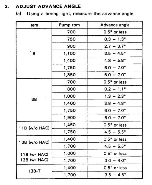

Has anyone here attempted to tune their pump timing curve by altering the springs or shims on the automatic timer (AT)? As the AT wears does timing advance or retard? I'm thinking it advances because there would be less pressure on the springs that limit pump advance. I'm specifically talking about a 3B but I think the principles are the same for any of the inline mechanical injection pumps
A lot of folks here insist that the only way to properly time an inline pump is using the prescribed spill tube method in the FSM. Static pump timing doesn't help determine how far advanced the timing is at higher RPMs.
Here's a snapshot of the advance angle specs for the automatic timer from the B Series FSM. Note that pump RPM is 50% of engine RPM and the pump advance angle would be double the figures in the chart. i.e. 3B engine at 2800RPM should have 7.6 - 9.6 crankshaft degrees of injection advance. A 13B-T would have a max of 1 degree at the same RPM. The 13B-T automatic timer ramps up quickly between 2800 to 3400 engine RPM to a total advance of 7 to 9 crank degrees.
