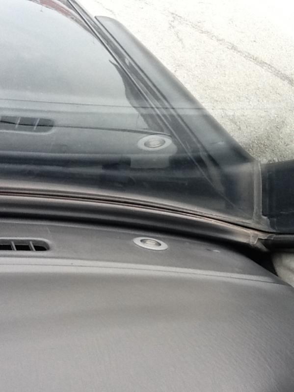

Ok, got around to take pics of 'auto light'. Switches off light @ door open, switches on @ 'dark threshold' e.g. Under tree shade. Truly set and forget. But I rather like to turn things on/off myself ;)
The ' light on' setting on stick switches on beam in all situations, regardless of key out/door open etc
1 Ambient light sensor on dash 2 auto setting on stick
