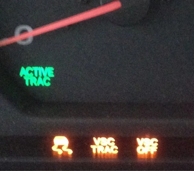

When I turn my truck on, vsc trac lights up on the dash.
Picture in next post.
The lights do not stay on very long.
