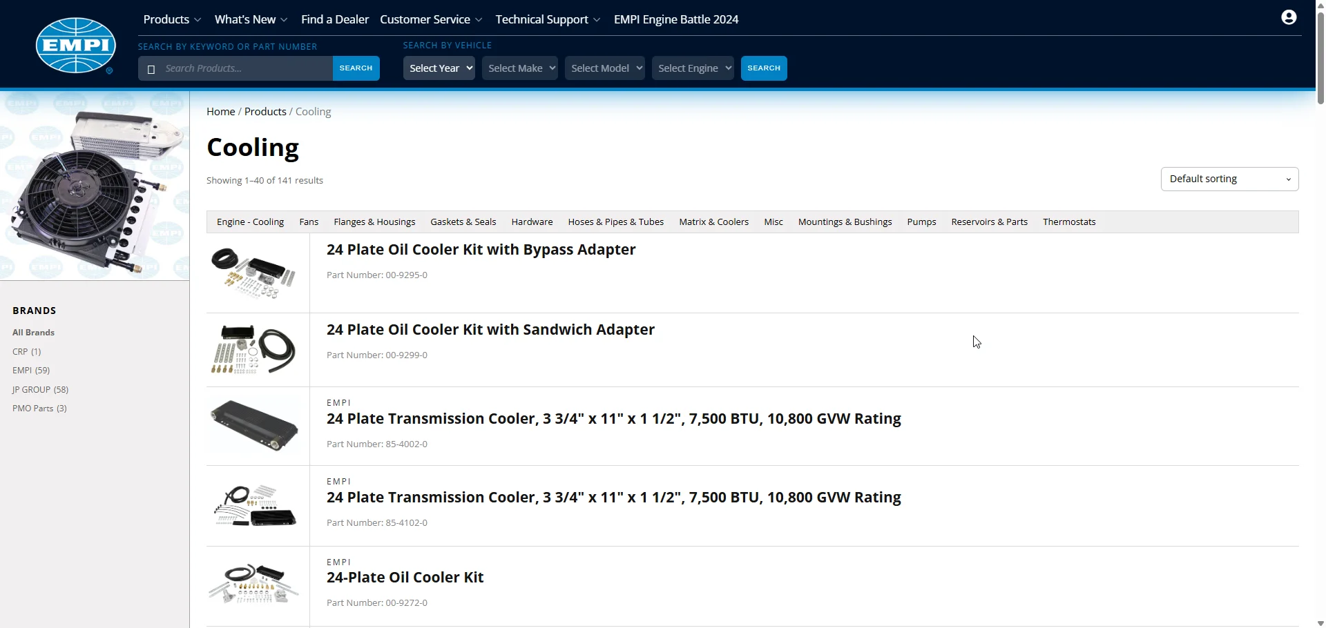

i've tried searching but couldn't find my exact issues i recently accured a 1996 LX450 with automatic A343F transmission, on 35s with 4.56 gears. It has an upgrade transmission cooler installed by the previous owner which i think is a EMPI A343F cooler. When on the highway AT temps are normal around 155-188 but when offroading in WV few weekends ago I looked down at the transmission temp gauge and seen it was 220, so let it cool for a bit an tried touching cooler but it felt like room temperture like the trans oil wasnt circulating? sitting even for 20 mintues didnt cool it down only driving down some hills getting airflow did the trick.

Good grief! That's a serious cooler.
