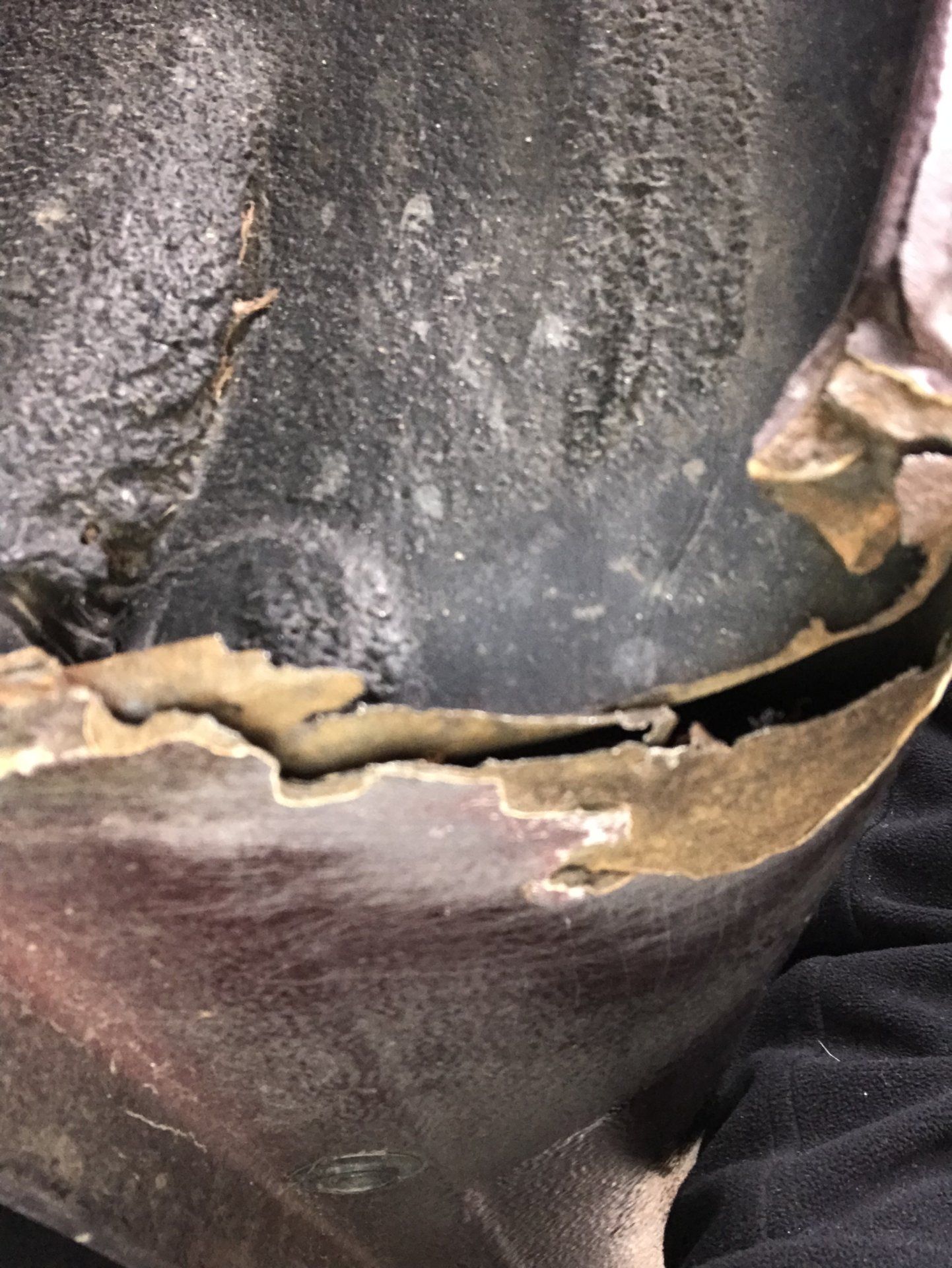

I sure am getting a crash course in rust with my 01 LC. First had the roof rust from a bad windshield now I have right rear rocker rust that had been hidden by the damnable running boards. Took it to a body shop who wanted minimum 1500$.....that’s not happening. Treated with some POR 15 so far. What have people done for this (did some searches already) specifically weldless applications (fiberglass?) so I can do it myself...

Once you have rust started, the only fix is to remove it completely by cutting the panel out and welding in a new section. Fiberglassing over the rust only hides it and allows it to continue to spread. Rust is just like cancer, if it’s not treated properly, it will spread and destroy. Get another estimate, but pay someone to fix it properly.
I will be following as I have something I noticed the other day in this area.... Is this rust from the inside out ? or mud dirt on the lip , road grim kicked in this area...
A proper repair would entail cutting out every bit of compromised metal and replacing both inner and outer pieces either by welding or panel bonding glue. Fiberglass and filler is a temporary fix at best. Personally I would cut out the rockers and weld in rectangular tube. I did this on a Grand Wagoneer I used to have. Used 10 gauge rectangular tube. Preserved the original sill plate and afew inches of the inner rocker apron and burned it in . Requires fab work and if you have to pay someone will likely run you as much as a proper rust repair. Just a thought but its likely that the rust is far more extensive than it appears at first glance. It always is.
I’m going to take it to a cruiser mechanic/restorer in a nearby town and see what my options are. I like the concept of welding in a bar...but just bought step sliders...
Mine has opened up on the side and there was mud packed in there and rusted from in side out..
I have the same issue, my dad is a retired body man, we are going to take care of it this summer.

I have this same thing starting too. Was thinking about just spraying in some fluid film or rust converter from time to time to slow it down.. not sure that will do anything but I will probably never redo body work on it.
I just figure that is a nice large weep hole. Salt and water cannot stay in. And I have driven a Honda um thats not much fun. Your Cruiser is 20 years old the rust may completely take over in another 20 and even a toyota will have give up the ghost.
Hard to say form the pic, but I think that is where the sunroof drain discharges to. it drains inside there and then empties out a slot in (if I remember right) the pinch weld. Good place for dirt to collect and cause that. I'd just grind it back to clean metal, POR the crap out of it (getting the POR up inside) and mostly forget about it. Just keep an eye out to make sure it doesn't get worse.
