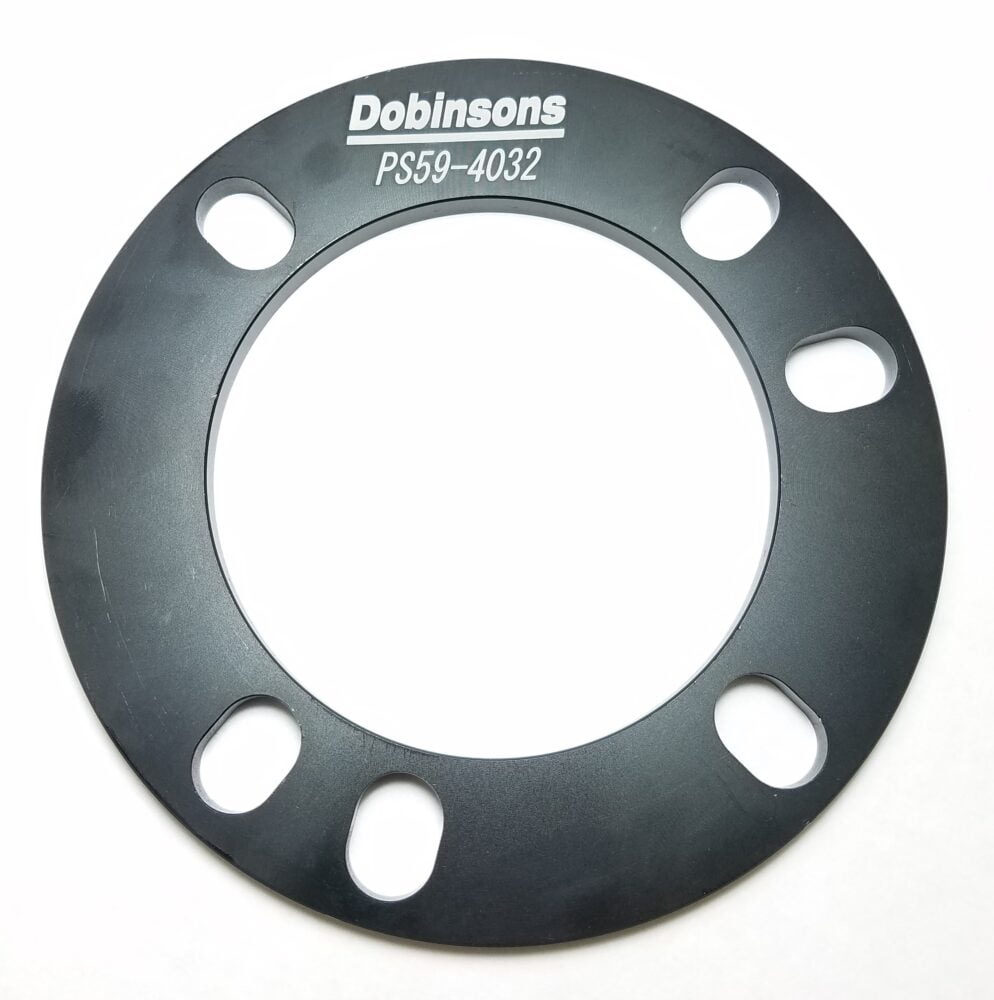

These twin tube struts and shocks we have are the closest to an OEM type ride. The struts don't add any lift height, as you'd reuse the OEM coils on them, but you can add the 1/2" lift spacer on both sides to pick it up just a smidge. The next height option we have is with new coils, which give 1.75" of lift.
Or you have the 5100 monotube option and to add preload. Those are definitely on the firmer side though.
