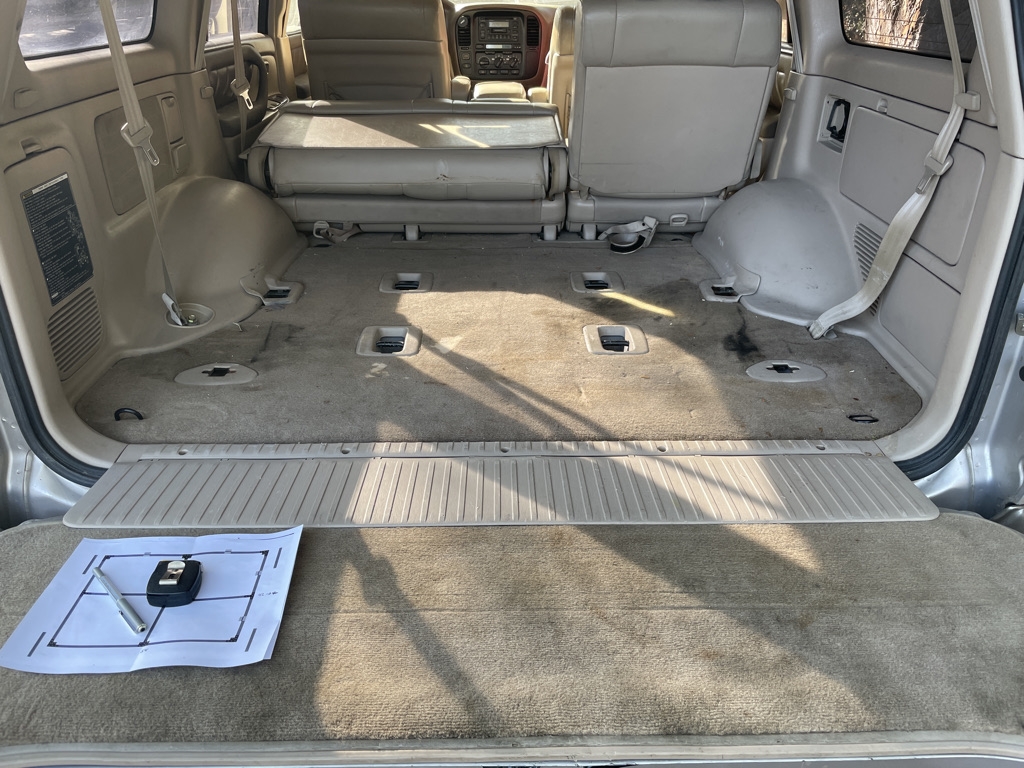

The vehicle I measured to base the design on looks like this:
Yes, rear A/C will have a smaller footprint. Your mock-up vehicle is not common, maybe 10% of all US 100's.
Crap 😐
Is it just this area that's narrower?
Thanks again for answering all my questions!
Correct... that area including the rear pillar area... that juts out.
