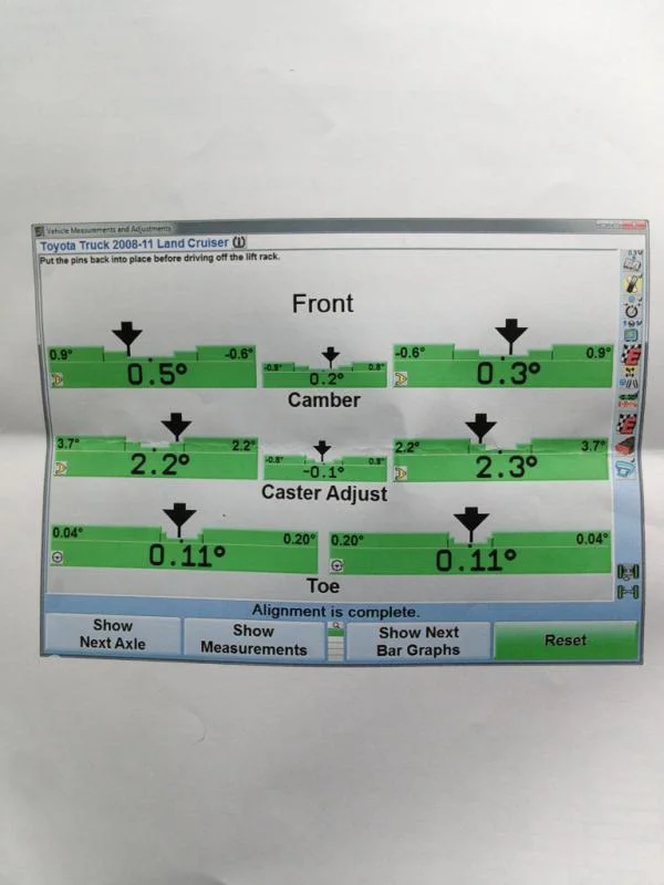

Do you have your post alignment report data? If so post it up here. If you have had it done more than once they should have supplied you with the data in hard copy. I'm betting you have incorrect castor settings with that torque steer going on.

Here is the post alignment printout. The shocks are the fox 2.5 IFP series, no idea the spring length but pretty positive they are set at minimal preload. Fox 883-02-030

Just got the lift installed. Ironman. Rides great and tires are next, but the alignment shop pointed out not being able to get it to spec which now that I read this makes sense.
I'm not getting pulling on acceleration or any other symptoms but worry about tire wear. Question is, are UCAs something you think is mandatory? And if you forego it how is your tire wear over the long haul?

Update. I took a 1500 mile trip last week and noticed tire wear and driving impact of being out of alignment. I had already decided to get the TC UCAs so they were waiting when I returned. Installed, aligned and my opinion, at least with the Ironman lift at 4", is that UCAs are if not mandatory, at least highly recommended. Complete change to the handling and I could tell the tires would have lost a lot of life without them.

The Total Chaos UCA's allow for more down travel because of the unibearing design. Your up travel still remains the same and that is the max compressed length of your strut/coilover.
The Total Chaos UCA's will correct your alignment so your problem with your 200 series pulling to the right will be eliminated.
The alignment is off, or the lower bushings are bad and allowing the alignment to change. Do you have the alignment specs? Jumping a vehicle is hard on the components, and can easily knock things out of spec. Inspect the rear lower bushings for excessive movement.
The advantage of using the Total Chaos upper control arms has two major benefits. First is allows your factory alignment to back to stock for larger lifted applications, the stock uca doesn't have enough misalignment. Secondly it will let you have additional down travel because of the unibearing design. We have installed a lot of these UCA's on FJ Cruisers, Tacomas, 100 and 200 series Land Cruisers. We do have them available and if you have any other questions let me know..
