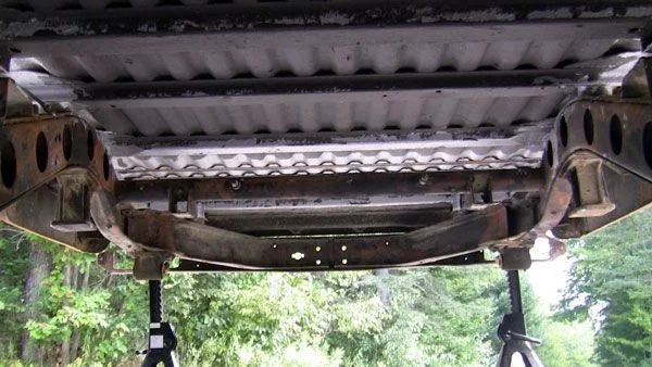

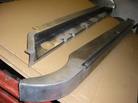

And there is a few good ones there - from what I see here the 45/47 sill is the same as the 40's - in this case Rufus' sill looks just like the 79-84 40 sills I have made.
Two pics borrowed from Rufus' thread
I would like to move the camera closer to the sill but I do see the resemblance in this first shot. I can see two of the six drains and the slope of the mount area
And here I can just make out the lower lip of the outer skin

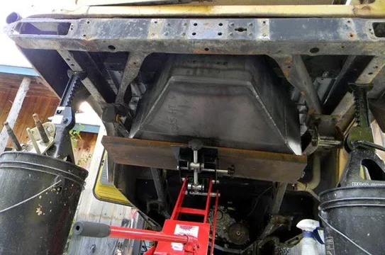

Here is mine
