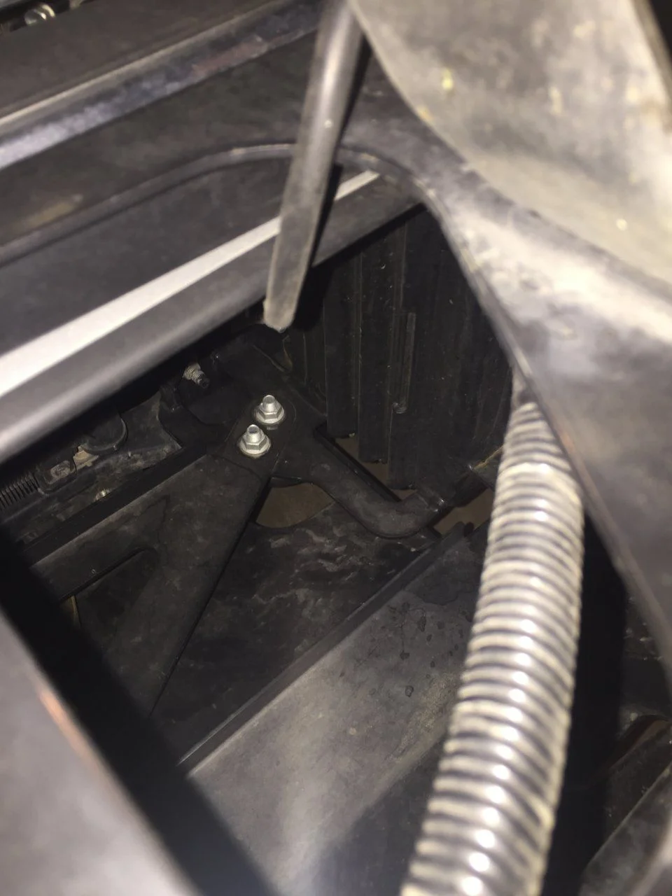

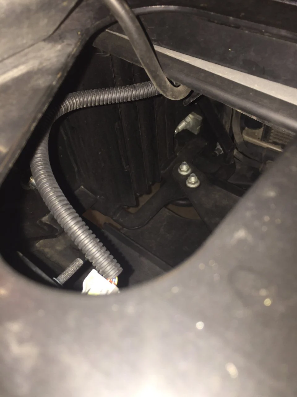

Here is the crumple zone for the arb. Hard to see in pics but is there. Not sure if tjm has anything like this?
