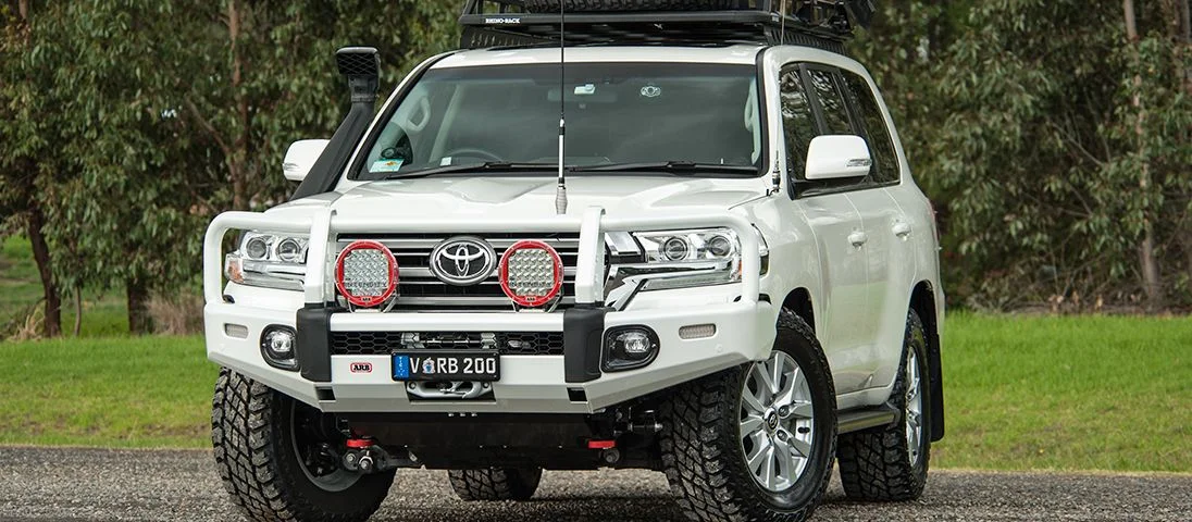

Has anyone successfully installed a Summit bar from ARB for a 2016+ LC 200 on a 2012-15 model? For some reason ARB is not making a Summit bar for the earlier design. I can see it is similar to the Deluxe model, but I have a Summit bar on my GX 460 and like the separate fog/markers and the fact that the Summit allows the winch controller to be lower and not obscure the adaptive cruise control or camera. I also like the hidden winch lead. My Warn control box is IP68-rated and I used an antenna extension up at the top of my firewall so water intrusion is not an issue at the lower level. Some photos below for reference.
I understand the pros/cons of the location, but am asking purely for practical purposes if it has been done before and how easy is it to replicate? Besides not being able to use the same bumper trim guides, is there anything else different in the design of the 2016+ 200s from the 2012-15 models that makes mounting of the Summit bar difficult or impossible?
2016+ Summit bar:

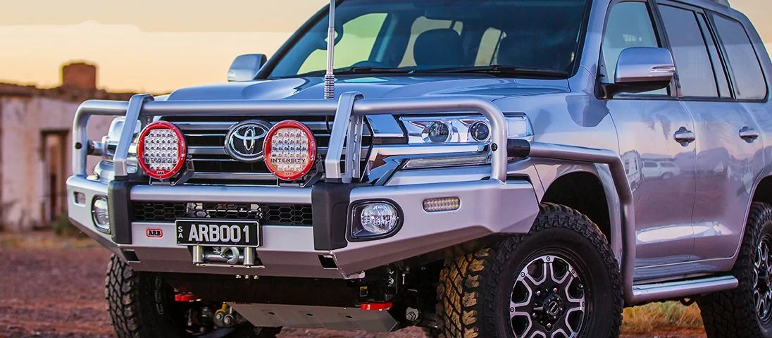

2012-15 Deluxe bar (note the winch controller in front of the emblem):

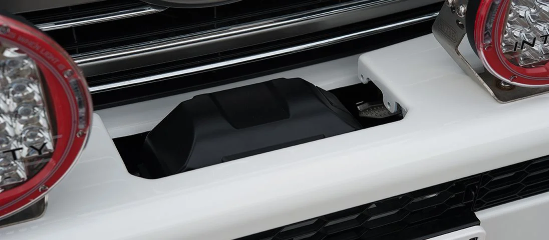

Detail of Summit bar with Warn Zeon controller:

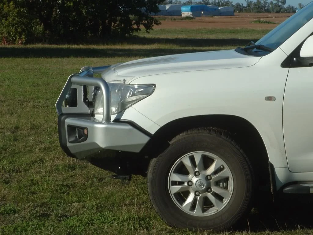

I am curious about it as well. In some pictures it looks like the 2016+ Summit bumper sticks out little less than Deluxe on 2013-2015. But is it optical illusion because of the higher hood line on 2016+ LC the hoops go little higher as well as to not obstruct headlights?
Below pics of Deluxe on 2008 and Summit on 2016+ LC and 2016+ LX.
