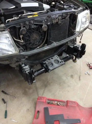

No signs of frame damage. OEM bumper and cover looked perfect. The mounting bracket slipped right on and the gaps look the same side to side.

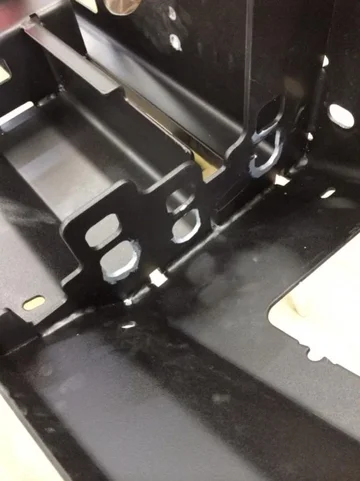

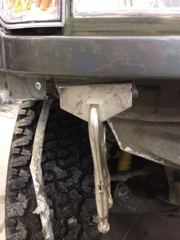

I had to bend back this tab on the pass side - I think the bumper or the rubber seal was hitting it.
Here is where I elongated the mounting holes, but still the pass side isn't perfect. Pretty weird...

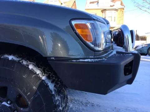

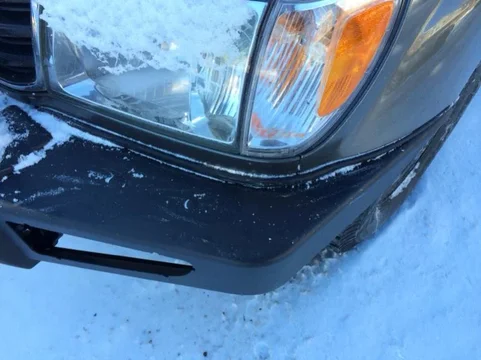

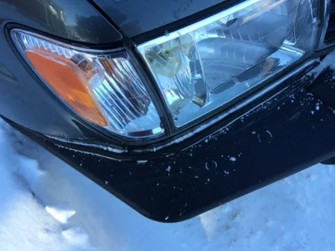

The photos are hard to tell, but the gap on the driver side is nice and even and the bumper sits back further, so the rear gap b/w the fender and bumper looks better.

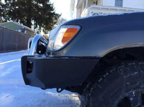

The pass side shown here, you can see the rubber is smushed down a bit more, so the gap is smaller. This was needed to keep the wing tucked up close to the fender. But the gap isn't as uniform.
It's not terrible, but just weird that the driver side lined up perfectly and the pass side req'd massaging and still isn't right.
