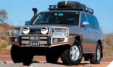

Doron has arb bull bar NOT deluxe , deluxe more expensive it has place to mount ur hi lift and its shorter than arb bull bar.

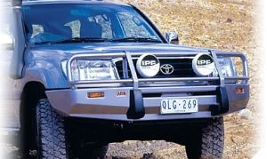

Someone on this board has done it, but it requires some cutting of a tab on the frame to slide the mounts over.
The older ARB Deluxe bar for '03+ 100's required the removal of the frame horn tab. I think there might be a newer version that uses a spacer instead. They might have even changed the winch mounting design.
Anyway, here is the older style '03+ Deluxe bar on my '98 LX. The main appearance difference in the pre/post 2003 100's is the shape of the grill. The newer ones protrude forward about 1/2" and so when using a newer bar on an older 100, there is a 1/2" gap directly in front of the grill portion. Hardly noticeable. The '03+ deluxe bar has the advantage of Hi-Lift jack points and provisions for fog lights.
