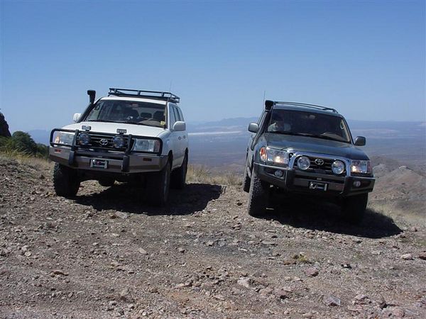

Shotts's stuff is custom painted.
his bull bar...sliders...rear bumper...basically all the stuff that gets scratched and scraped on the trail...he had painted.

mine was painted by the original owner of the bumper, I paid $400 for it.......so I am fine with the color.......which reminds me of fj40 bumpers ;)

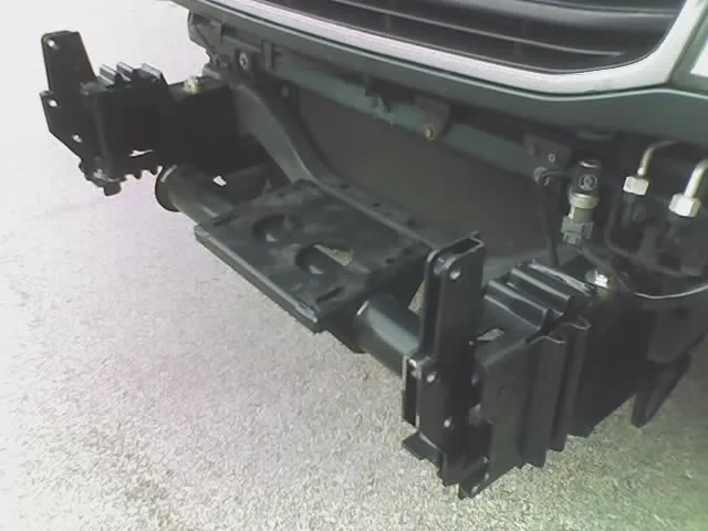

I'm not sure about some of the newer models, but the Deluxe Bar on my 01 is two piece. The winch mounts to a separate frame mount and then the bar bolts to it with 4 bolts on each side.
That looks exactly like the sahara bar mounting bracket. The winchbar on my old 4runner is all one piece and doesn't slide into frame horns like the 100 bar, but instead sits on a front crossmember.
