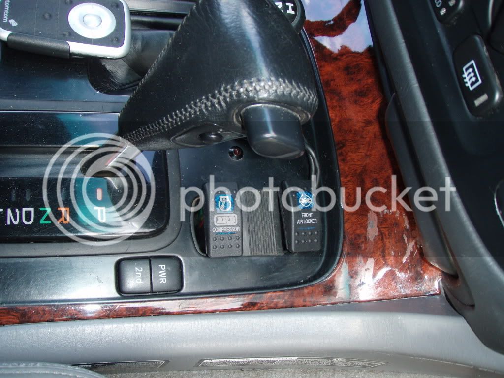

If you have the original Toyota locker in the rear axle and you add an ARB Locker to the front axle you don't have to do anything, you don't even need the rear locker switch. Just leave the connector for the rear empty. As soon you switch the compressor on and the front locker switch the axle will lock. Different would be if you have also a rear ARB locker and connected to the rear ARB locker switch, then the front locker only locks after the rear switch is on.
In my 100 I have the OEM locker in the rear axle and the ARB locker added to the front axle. I can now use both independently.
I have added a rear ARB locker switch to a later date but it was purely to fill the gap and also looks better.
