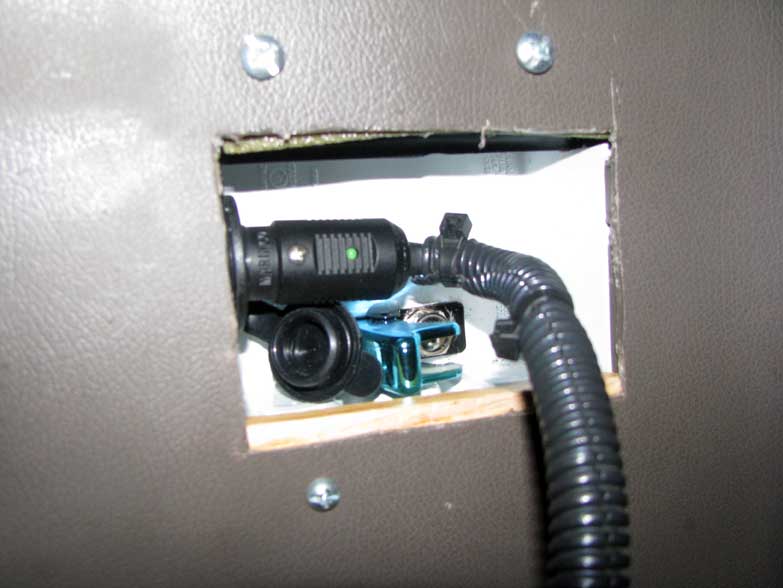

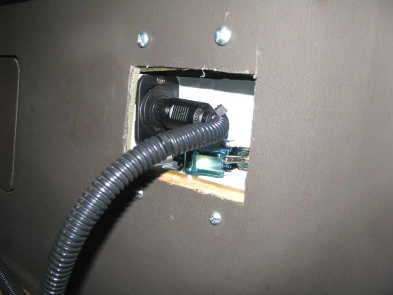

It ended up uglier than intended, but here's my rear DC power port (a Marinco locking one) that I used a plastic house wiring box to provide a place where it doesn't stick directly out from the cabin wall.
Pretty sure it was 10 gauge wire I ran to it. Cozied the wire into the left side harness loom, through the firewall to where it's fused to the primary battery.
The guarded switch allows me to kill the fridge without unplugging.

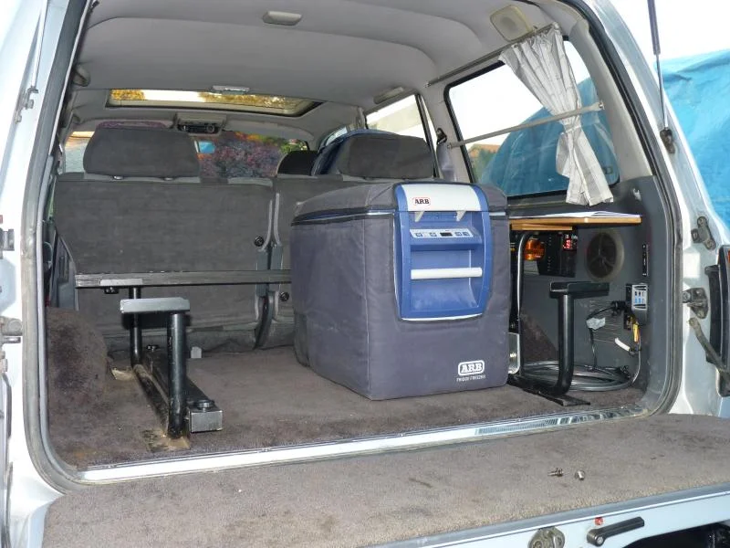

Finally, it's all done! 1500W inverter, 50W solar panel c/w regulator, and constant 12V power.
Fridge is now anchored down on an aluminum plate, it will do until I win the fridge mount at Rubithon this year. Which reminds me, I will have to see if the Margarita machine will still fit in once we finish packing. :p
