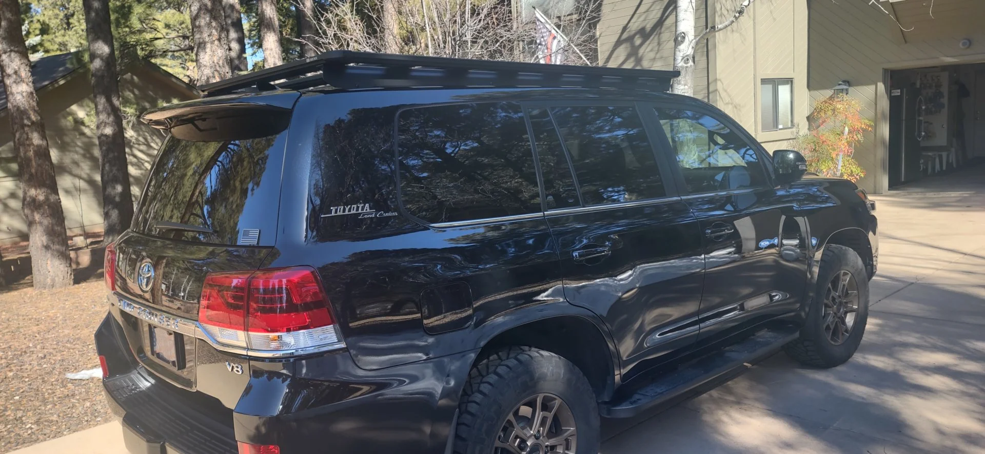

I installed a 51x84 base rack with wind deflector and the Slimline light bar on my 2020 HE and does not create any more noise than the factory rack did. Note I never open the sunroof, so I don't get the buffeting through the sunroof as many here complained about.

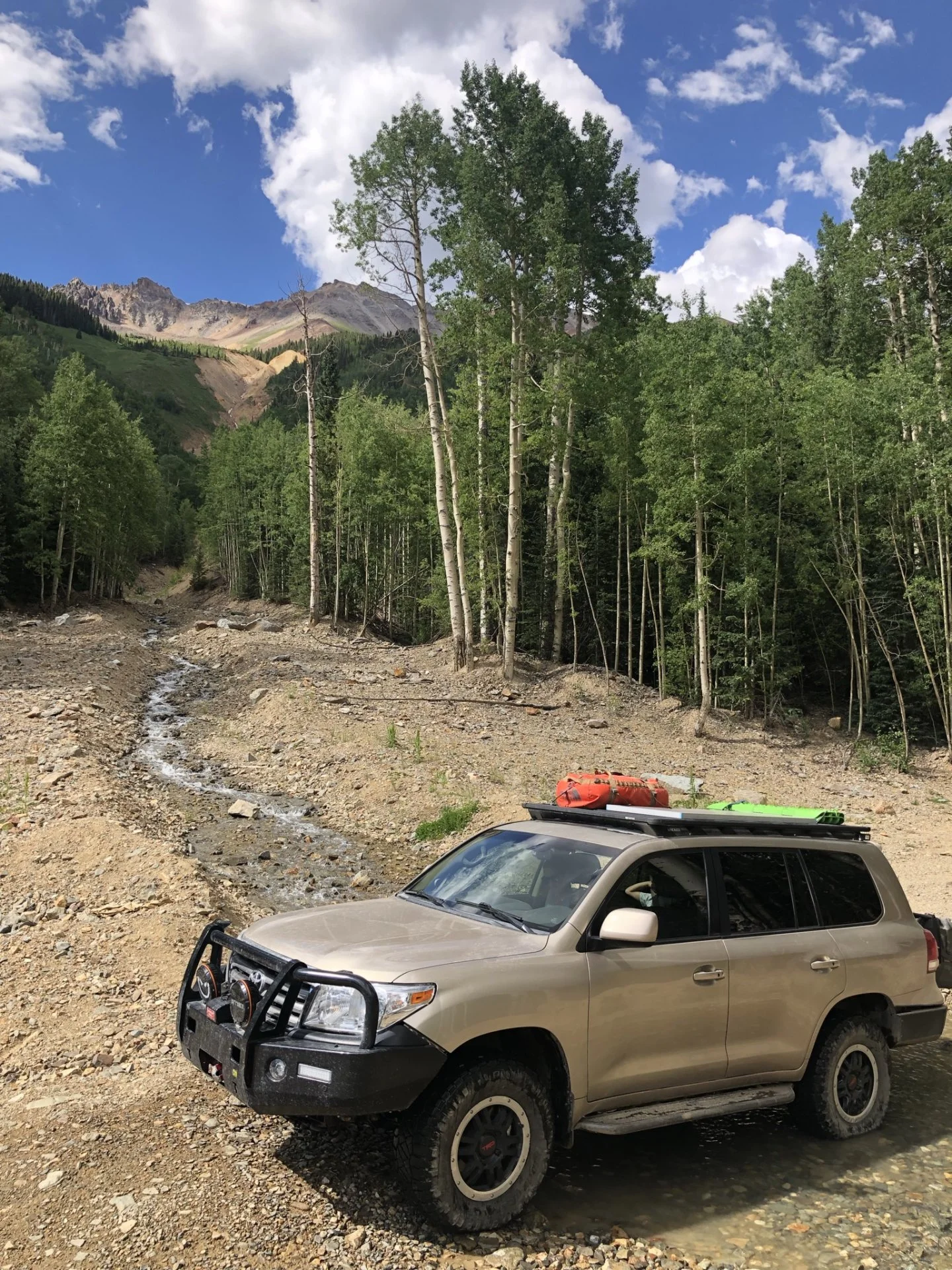

I also have a full length ARB Base rack with wind deflector and there is no discernable wind noise. Although, I'm not sure how much noise would be added by the rails.
I have the same as above. Nothing noticeable except a 1 particular speed and wind direction on the highway. Sound is coming from above my head but can’t pinpoint why it only happens in that 1 particular scenario.
I had one of those Baja Rack universal Mega Mule’s before and that was noisy all the time.
But yeah LOVE the rack otherwise and IMO looks so much better than any of the alternatives

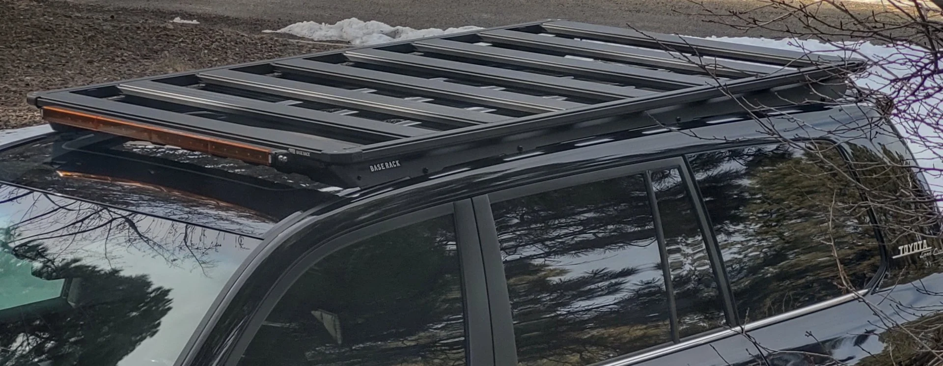

I have a full length base rack that has been hanging on my shop wall for the last year or so. I like the looks and the function of the rack, and the welded aluminum is stout. But it was way too noisy, I had to remove it. Sunroof is rendered useless due to the noise.
I came across this thread looking for ideas for a custom fairing - like the old thule/yakima rack style from the 90s. I don't understand ARBs wind deflector design, It seems to create noise rather than eliminate it. I've been considering fabbing up a different style of fairing that throws the wind upward rather than dumping it into the sunroof. Anyone tried anything like that?
