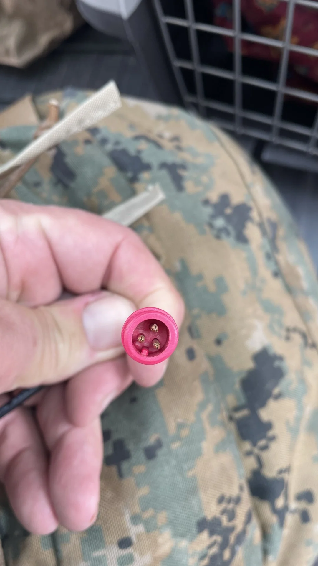

why are there three conductors?

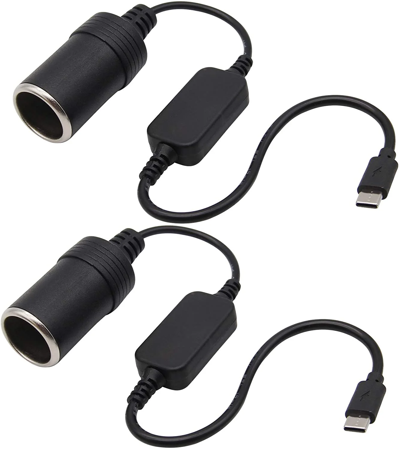

I make it independent; I think running the power code to that amazon plug and then to one of those cell phone charger packs would work.
similar to one of these..
Amazon product ASIN B07VGHLRTQ
