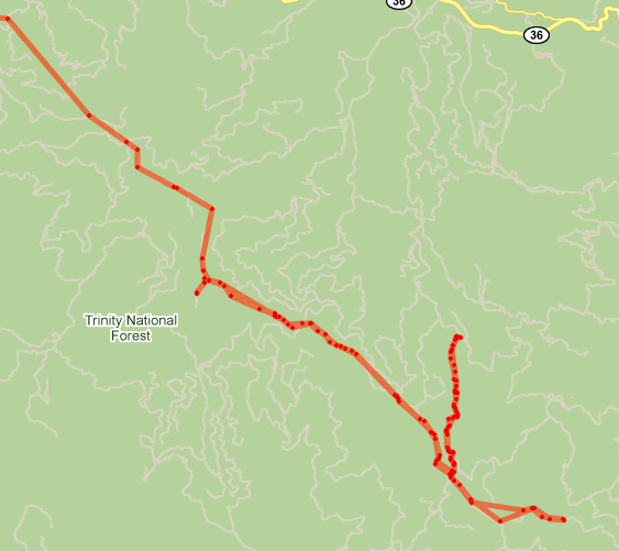

Here's a few tracks from a couple of years. Driving up in the mountains in winter:

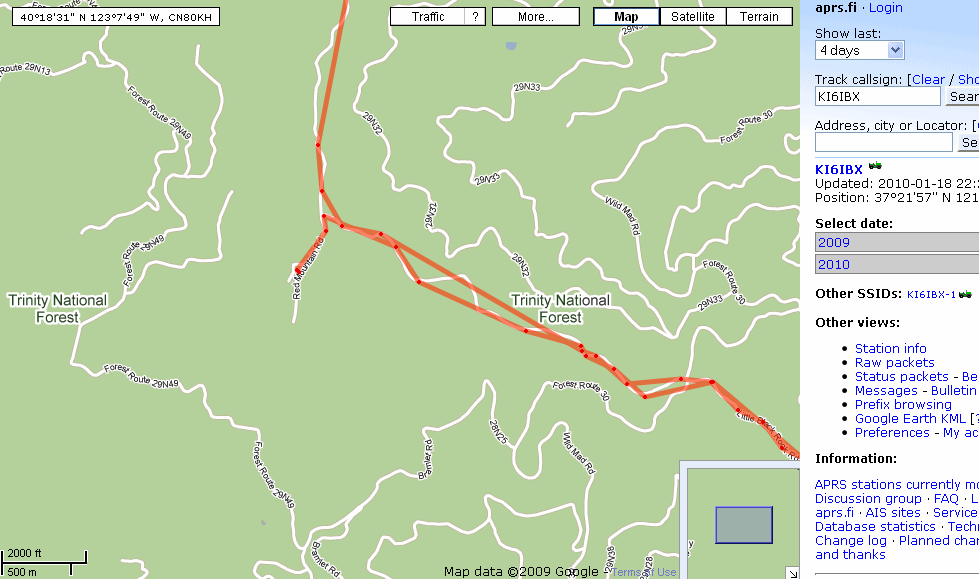

and

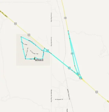

and this kind of terrain:

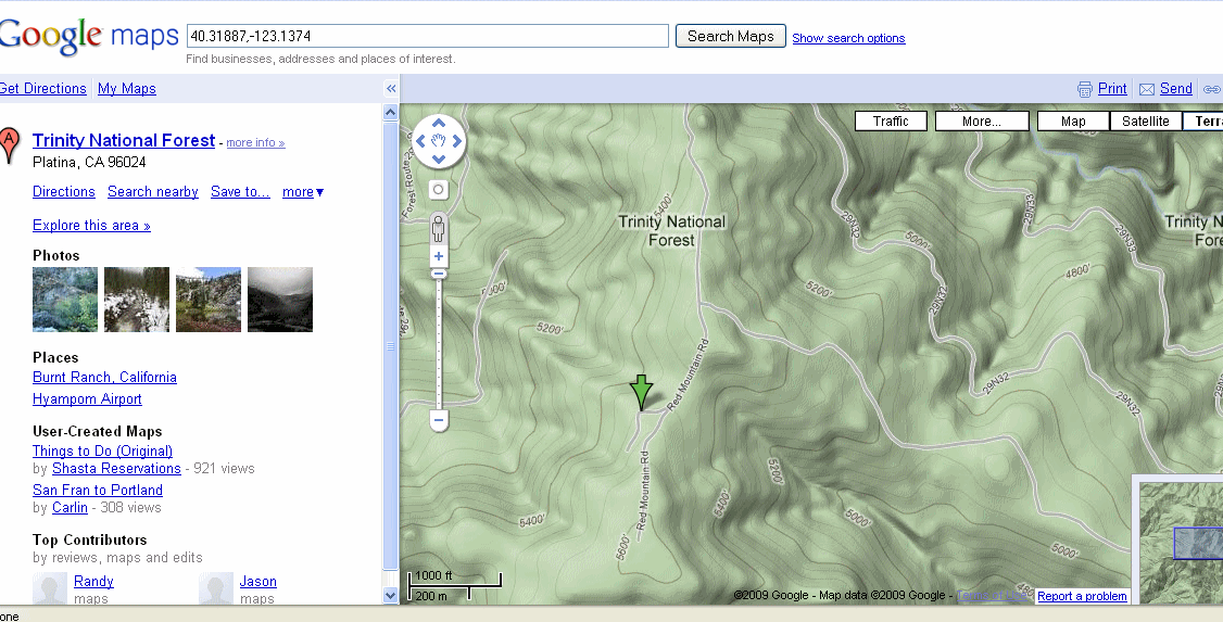

and a fix from Spot:
I run a yaesu ft-857d connected to a home made APRS tracker unit. Been using it for several years when we go on trips. My wife can then see where we are (kids & I) as we drive around on our camping trips. Spot has become a secondary mechanism to report position etc.

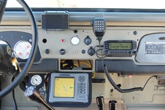

Congratulations! I really like mine, and my family likes being able to track me in real time on the internet when I'm on a long road or 4WD trip. I have a Kenwood TM-D710A and an AvMap G5 GPS that I can switch between trucks.
Since this photo, I've run the power for the GPS through the roll cage so it's all nice and clean with no exposed wires.
I bet that AvMap GPS integrates with the Kenwood a lot better than my Lowrance, since it is made for the purpose. I do get other stations showing up on my Lowrance display, but they only show as waypoints, no special icons. The callsign is there along with the location. I already had the Lowrance, so I made it work.
The AvMap is pretty nearly plug 'n play, but it's very expensive. It's nice to see other stations as icons; it's very easy to see which is an I-gate, repeater, or another mobile (and even what kind of mobile - there are different icons for cars, pickups, "jeeps", 18-wheelers, airplanes, pedestrians, etc.) but I'm not sure it's worth the extra expense just to get that. The other cool thing it will do is navigate to any other APRS station just by touching the icon on the screen. I used it to find some 4WD friends from a different state in the San Juan Mountains in SW Colorado last year.
