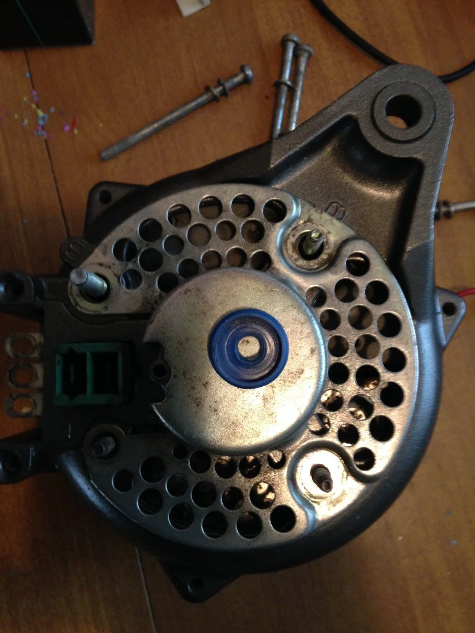

While I'm shaming myself, alternator mystery blue bushing:
Thanks, and again, my apologies,

Will -- Re: the alternator bushing, I have all the standard isolators installed, have looked at all my disassembly pictures, as well as SOR, FSM, etc., but still not sure what the "mystery blue" does/should go.
