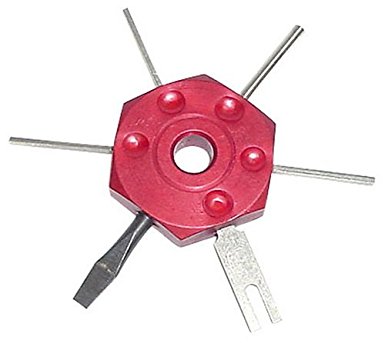

After spending a little time looking at the harness, it was discovered that they didn't quite do it right... the wires that were labeld were plugged into the wrong part of the fuseblock! So it's no wonder the "constant" power wire didn't have power - it was hooked to a fuse that wasn't even connected!
Here's a picture of a terminal extration tool you'll need to get the wires out of the back of the fuse block:
Here's the link from Amazon:
http://www.amazon.com/Lisle-14900-Wire-Terminal-Trouble/dp/B0002STTQG/?tag=ihco-20
That should do what you need. Or you can make the tool from a nail and a grinder. You push the tool in the back side of the connector and the wire will come out. Then you can put them back in the RIGHT slot...

Thanks tons Carter. It was great to meet you and thanks again for the insight, knowledge, and extra set of eyeballs. I will pick up the tool and switch the wires around (after taking the pics you suggested). I'm sure I will have other questions as time/wires go by. When you get a minute, if you would send me the link to the battery at Sears you mentioned it will be appreciated.
