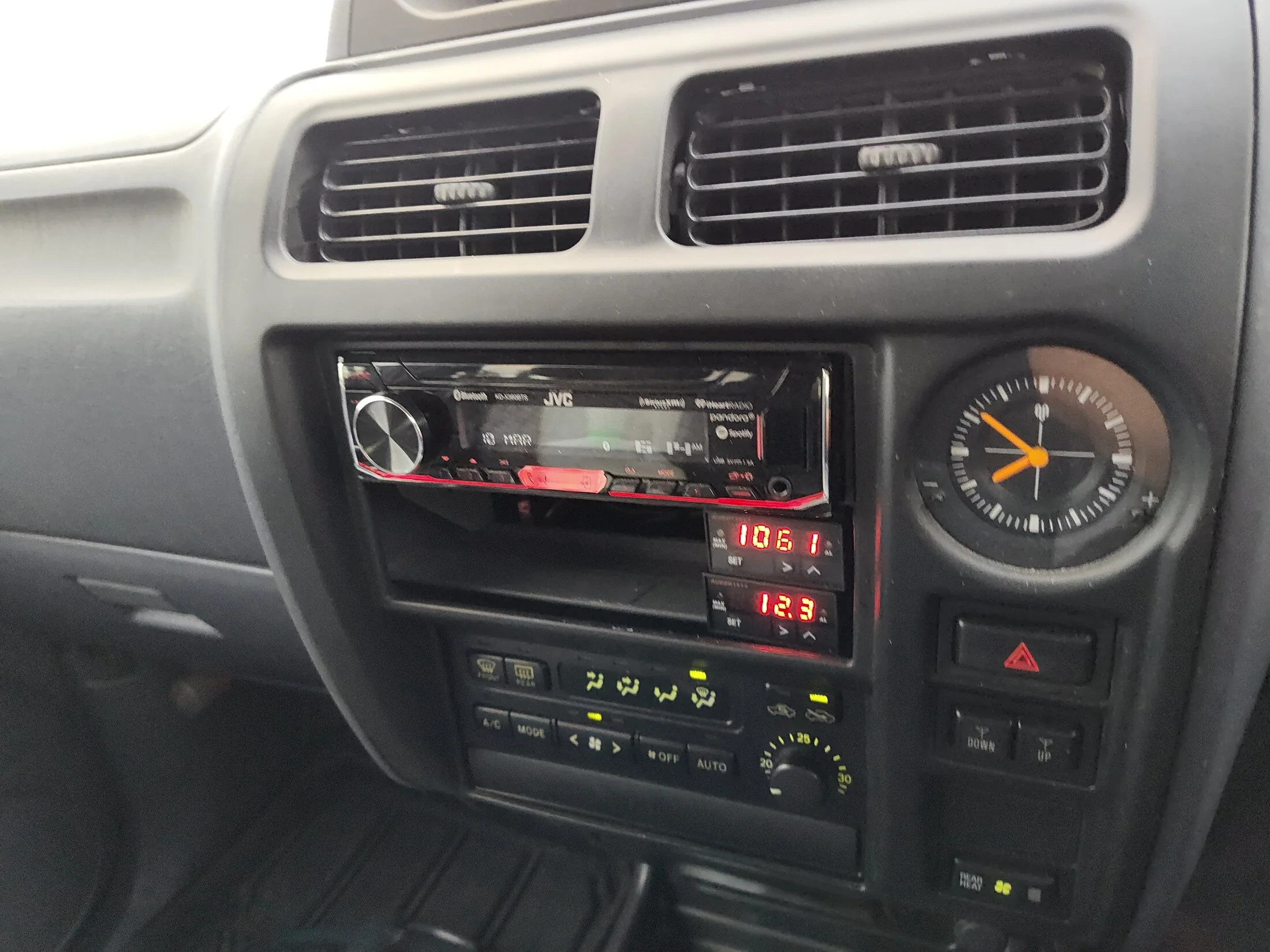

Alrighty, manual boost controller installed. That was quite a job to do since I left the turbo water lines in place. I don't think it would have been possible without some double jointed needle nose pliers. If you have any idea that you might install a manual boost controller in the future and you have your water lines off, definitely recommend proactively hooking up a loop of silicone hose, even if all you do is zip tie it out of the way until you get to the manual boost controller in the future.
Started with the boost controller turned off, then did some test driving and tweaking adjustment a fraction of a turn at a time, I got it so that it runs 12.7-13psi at wide open throttle instead of ~9.7-10psi. I did overshoot and it had no problem hitting 14.7psi and fuel cutoff, obviously I backed it down at that point. Adjustment is tricky, wish the adjustment bolt was fine thread.
EGTs are significantly lower. Used to have to be quite careful to not top 1200 even in normal driving any time ambient temp was over 70F, now that's no concern at all. Can still top 1250F but I really have to try to do so. Will do some more tweaking and try to get closer to 14psi and see if that drops that last 50F off. I shudder to think what was happening last summer, driving with no EGT gauge and trusting all was well; no wonder these things pop heads.
I wouldn't say it has more power(which wasn't the goal) but it does seem happier to rev and seems to pull better farther through the RPM range. That might just be me able to stay in the throttle without topping 1200F now.

Alrighty, couple more tanks of fuel on this mod. Probably my last post on this unless something changes.
1. Overall I love it, very happy with the mod.
2. Can easily hit 10+psi while at part throttle and relatively low RPM, and even boost spike to fuel cutoff if I flat-foot it in from low RPM. Not ideal.
3. Runs out of boost on the top end, ~10psi at 3500 rpms and foot flat on the floor, topping 1270F EGT. Tiny turbo that boosts at low RPM on a small engine, may just be running out of breath at that point and this may be as good as it can ever do.
4. I wish the adjustment was a little finer, might need a softer spring. Would like to not hit 10psi while at part throttle and 2000rpms, and would also like to hit 12+psi when at high RPM and foot flat on the floor.
5. Can easily climb any hill I want, at any speed I want, at part throttle, without getting anywhere close to 1200F EGT. Bingo, objective achieved.
6. I started watching the EGT gauge obsessively as soon as I got the gauge installed. This mod has let me stop doing that.
6. Last tank of fuel was 350km to half instead of 300km. Still skeptical.
