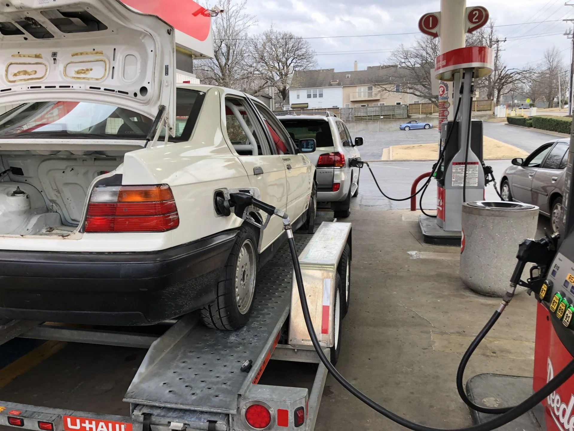

I used my 08 LX to pull my ‘93 BMW 318 racecar to and from the track. It pulled well aside from braking. Give yourself some room.

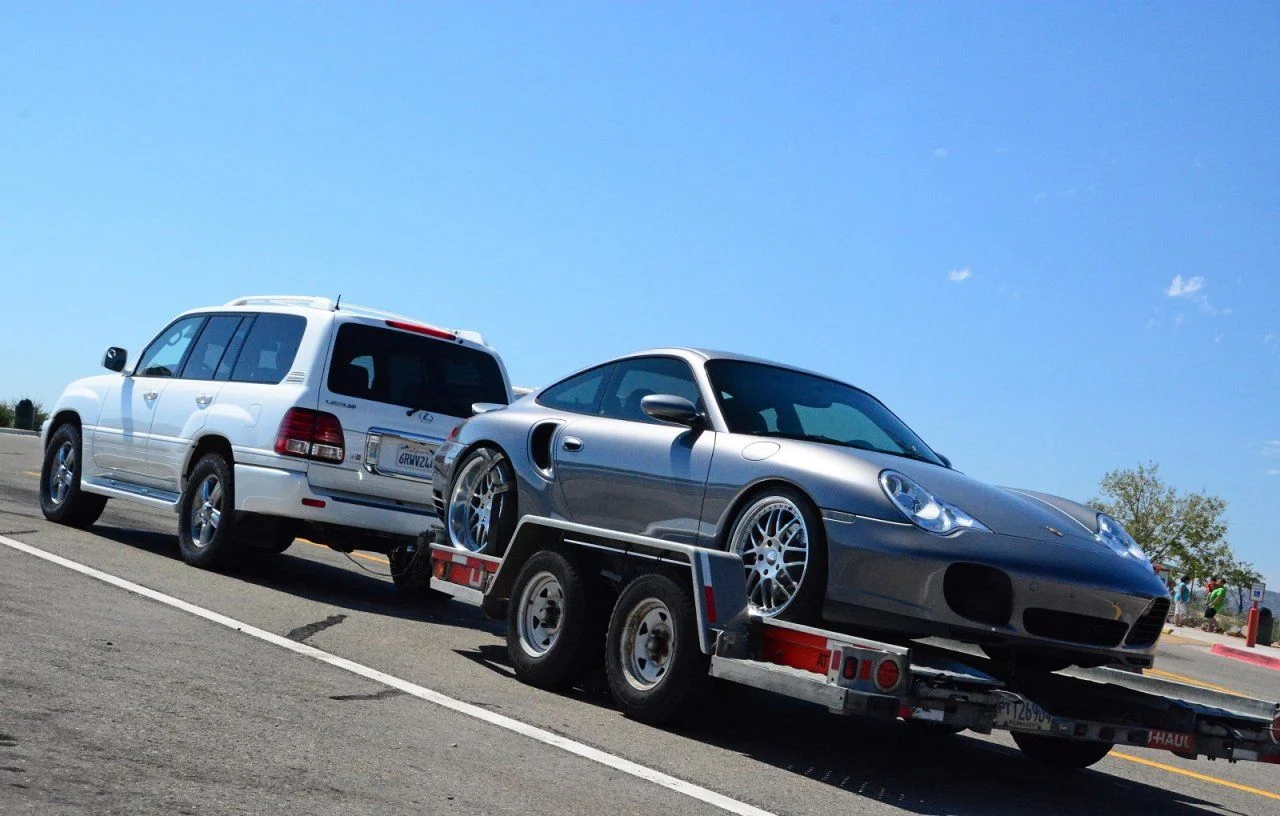

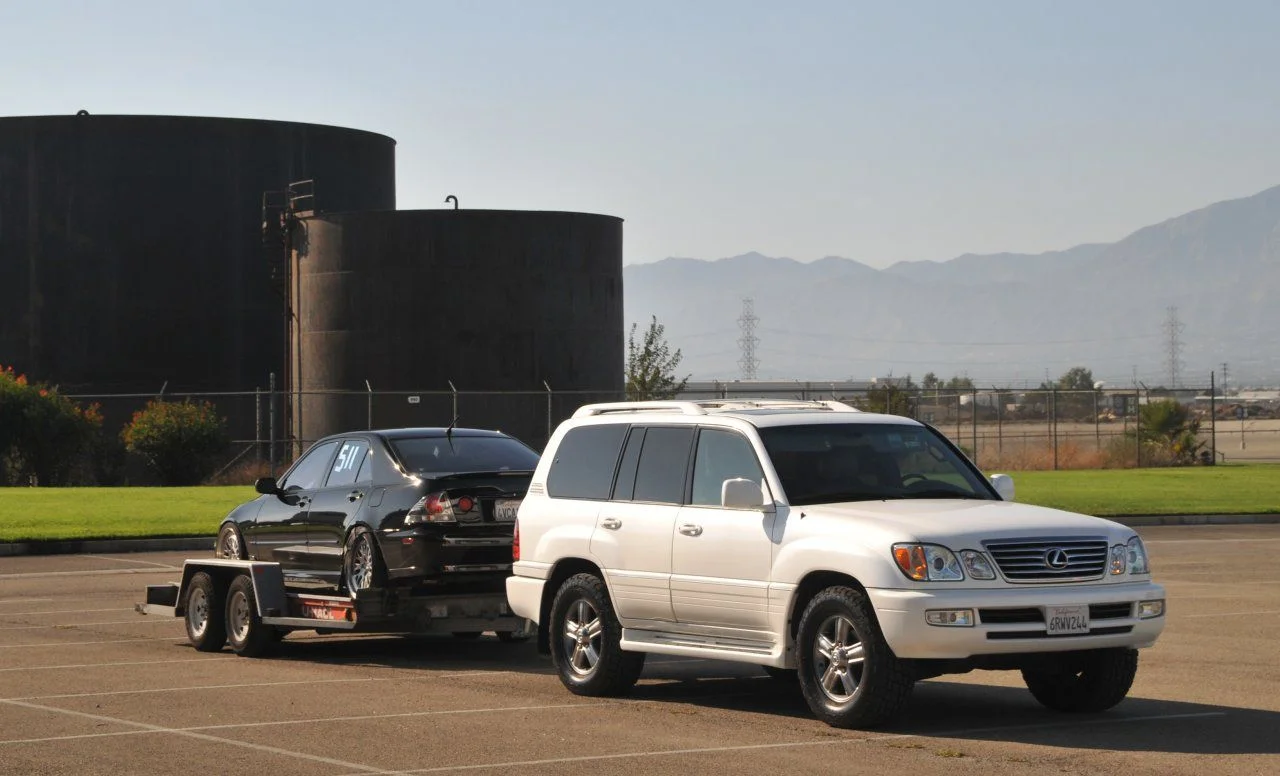

With your Lance TT experience, the car carrier will be a walk in the park. Superior sight lines and aero with the car carrier. I've done several long trips with them and they are great. Even beyond 55mph. It'll easily cruise at 70mph, without much concern for aero drag compared to a camper.
There are older steel and newer aluminum variants out there. Both are overbuilt, solid, and forgiving. I would be okay with either. IIRC, 2000-2400 lbs trailer alone. Recommended always load engine forward (for tongue weight stability), but with a CR-V being short wheelbase and relatively light, likely doesn't matter. I've always had to do tail forward on account of my cars being too low.
The surge brakes work just fine on these car carriers. There's an initial surge, but then they bite just fine. I've been on long 6% grades with engine braking, and all works fine. Unrelated, I've also done steep hills with 8k++ lbs on a hydraulic dump loader with surge brakes and that's very much an issue!!! The surge brake would engage continuously on account of the engine braking and cook the trailer brakes well before the bottom of the hill$!@

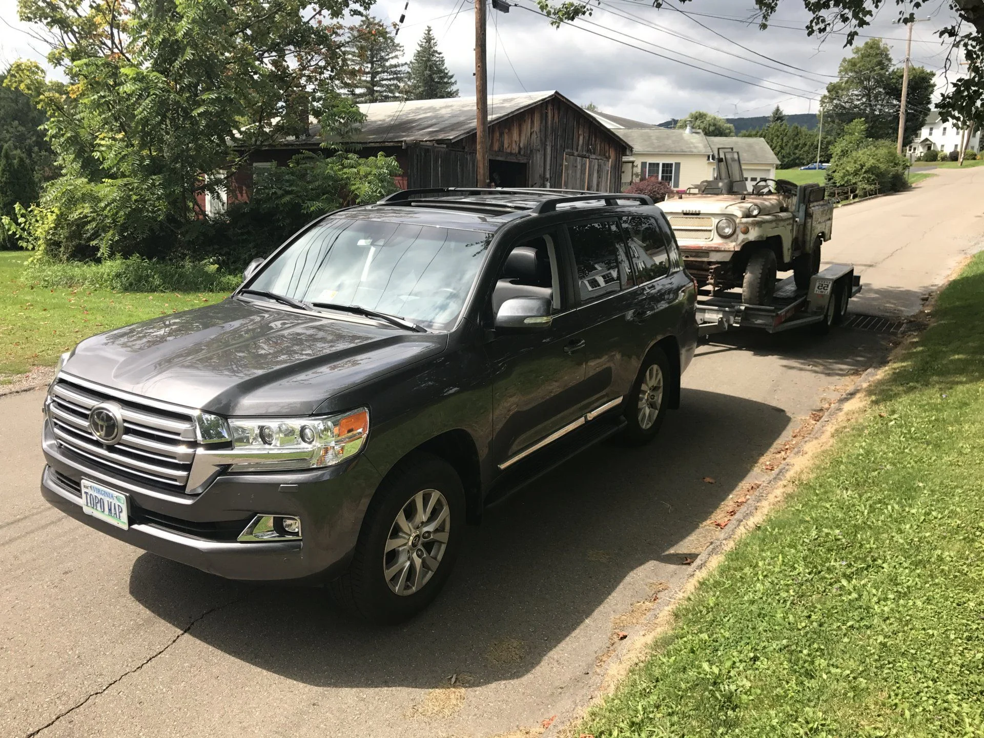

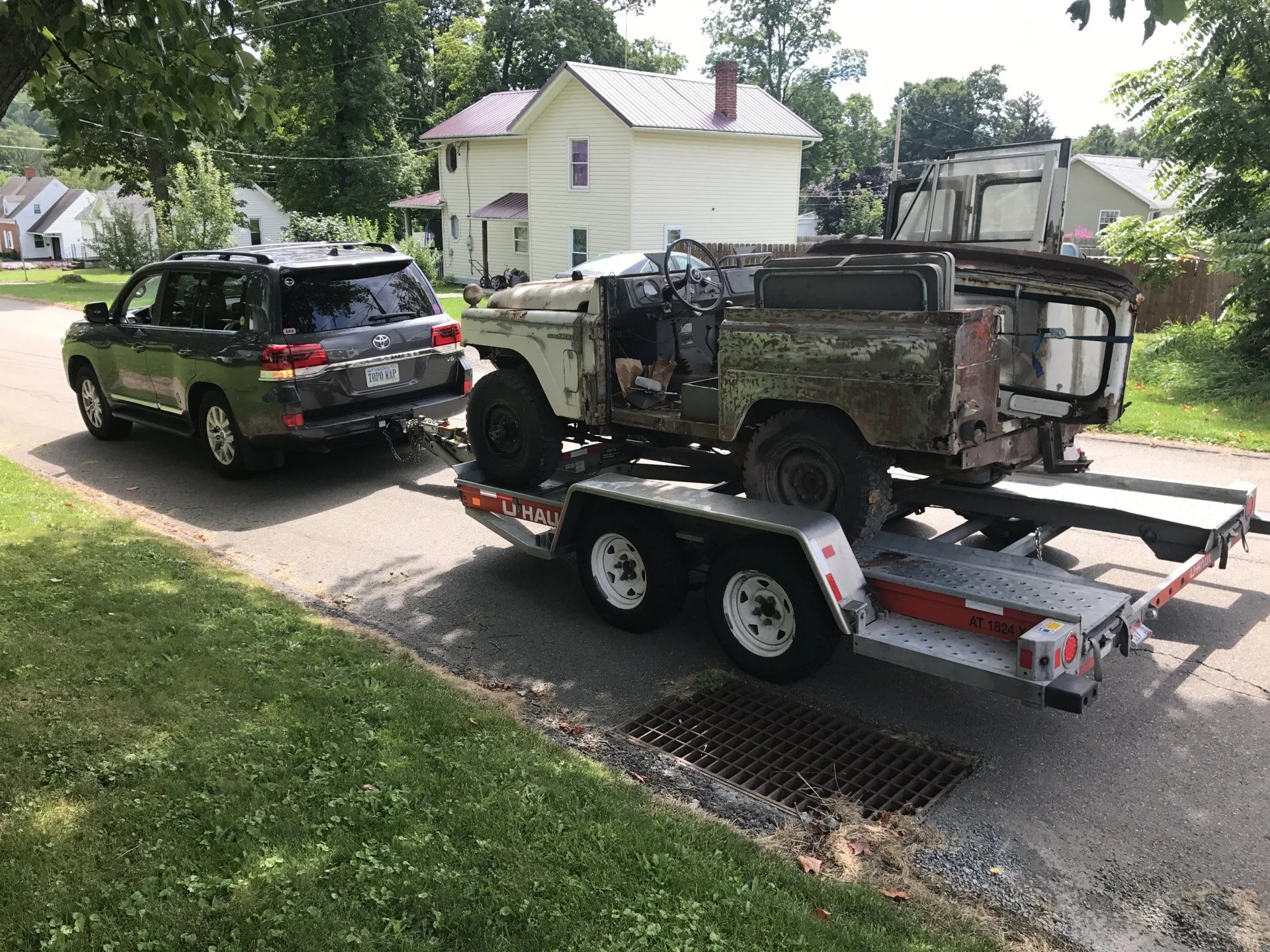

I helped out a friend of mine with picking up this Nissan Patrol that he’s restoring. Pulled the trailer up and back with no driving issues. The only thing that I was worried with were the lights on the trailer. They would not work with the 7 pin to 4 pin converter. We tried everything.

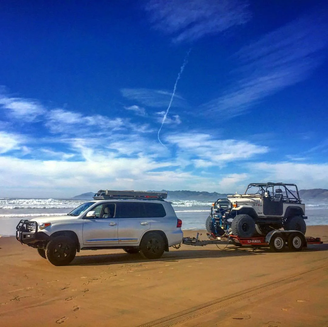

Have towed my 40 series on a UHaul tandem trailer from SoCal to Pismo several times. You just have to get used to driving with the surge break on the trailer. The UHaul trailers are heavy. View attachment 1660109
Also a great pic. Though, @ethernectar, you look like your dragging your tail a bit. Maybe your load is a bit forward?

These carriers are designed for the load to be all the way forward with wheels touching the front stops. There's no balancing for tongue weight. Though you could back the CR-V on, but it's not recommended by U-Hauls guidelines (engine forward). The trailer driver side fender (only) folds over for door clearance on low cars, but you won't have that issue.
