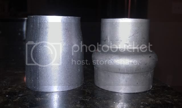

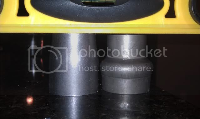

Got two solid pinion spacers from jt's parts and accessories to install in my 78 fj40 diffs since I'm installing 3.70 gears (had to get some multi drill flanges as well.) When I took the solid spacer out of the package I noticed its roughly 1-2 mm longer than the crush sleeve I removed. I didn't think much of it at first. First go I installed the solid spacer with no shims tightened the pinion nut to set preload and it stops before tightening the pinion shaft, a bit puzzled, I put my Ingersoll titanium 1/2 gun on it and let it loose, still doesn't tighten up. So I take the pinion nut off and remove the outer bearing, remove the spacer and upon inspection you can see where it was imprinted! Damn spacer is too long! Anyone else ran into this? Or even used one of these?
For $55 bucks a piece I'm a bit aggravated to say the least.

I think many years ago we used a mini truck solid spacer, just had a machine shop turn the spacer down a bit for setup..
Bit more work setting the third up with shims but worth the effort.

FWIW, these don't work in any of the FJ60 3rds. Your 3rd was NOT from an 80 series. I just pulled two 3rds from FJ62 front axles. Both of them had the same issue with these solid spacers. They are cut at 2.170", but that is about 1/8" too long.
JT's needs to get their R&D together as these will NOT work in FJ60 3rds.
I know thats why i posted and contacted them but they said i was wrong. BS i turned both of mine down and made them work. thanks for reviving my thread i had put it behind me now im hot again.
I was yesterday too. They told me they were sending me out the two to replace these. Then I see a charge on my CC for them + shipping. I lost it on them.
So, I just had a buddy turn them down today for me and will run these. Then I disputed the charge with my CC company.

The real kicker is that they weren't even machined straight from them. Now they are. They were .050 out on one side. BOTH of them were.
