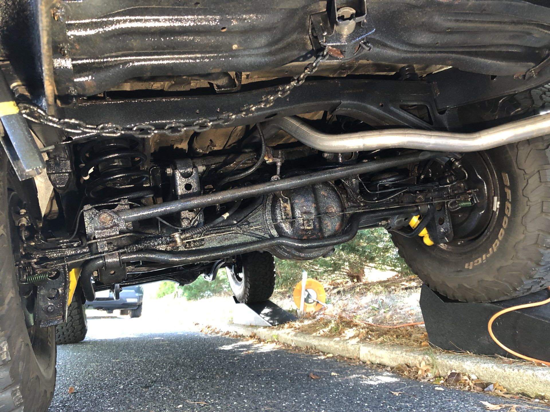

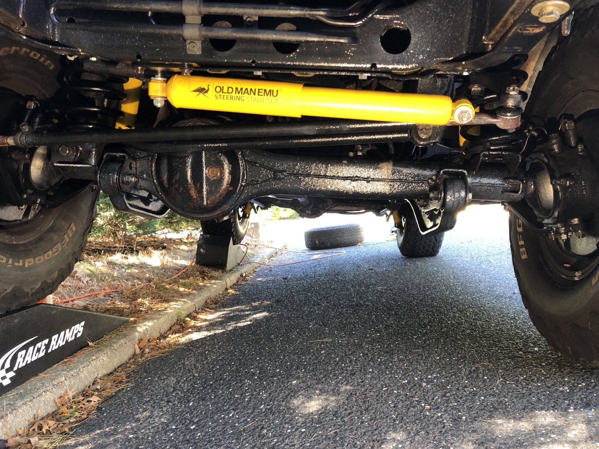

Did an application today. Used up almost an entire quart. Pancake compressor worked just fine. I would suggest getting the straight wand to reach some areas. Got the kit on amazon - 4quarts and a pro gun. I did not have any rust in frame. Just some surface spots where paint was worn off. Great stuff. Will apply again next year!

View attachment 2107783View attachment 2107785
Looks great ! We appreciate the feedback. If anybody needs any additional information about Woolwax, I would be glad to answer any questions. Below is a link to the kit described i the above post. Of course the promo code "ih8mud" is still valid and we appreciate the incredible amount of support that we receive from members of this forum.

I did 3 trucks in my driveway this past Saturday. Used up the last of the Fluid Film and switched to Wool Wax halfway through the second truck. I had to adjust my spray gun for the Wool Wax. It is a thicker consistency than the Fluid Film. Once I increased the flow rate, it sprayed on the same as the Fluid Film. I hope it protects the same way that Fluid Film does.

I will be going back again after I get my extensions to get deeper into the rails. I thought I did a very thorough job. Maybe an additional 1/4 but not 2 quarts. Post some pics of your finished product!
