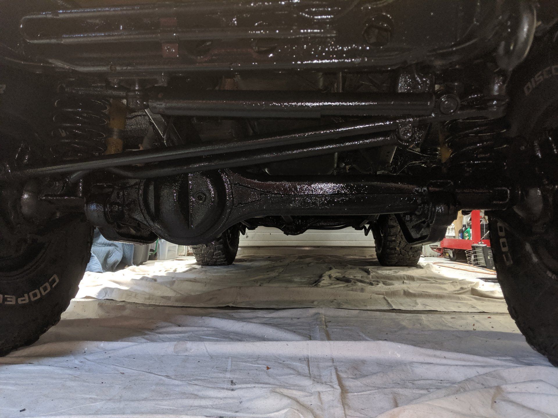

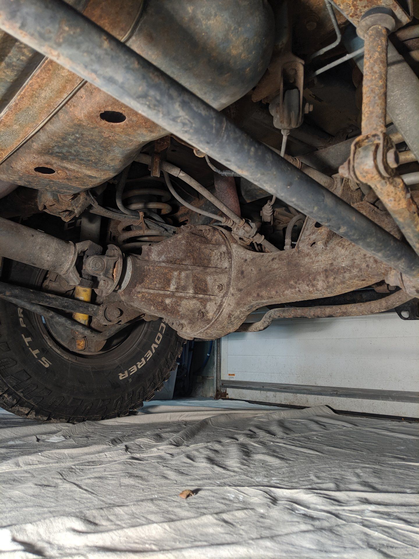

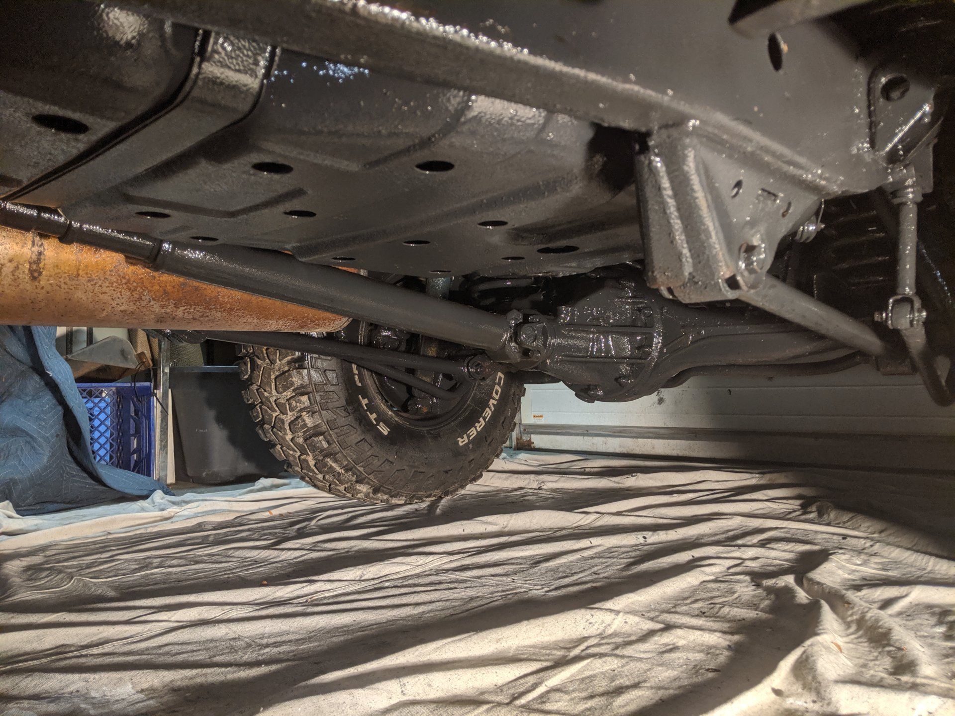

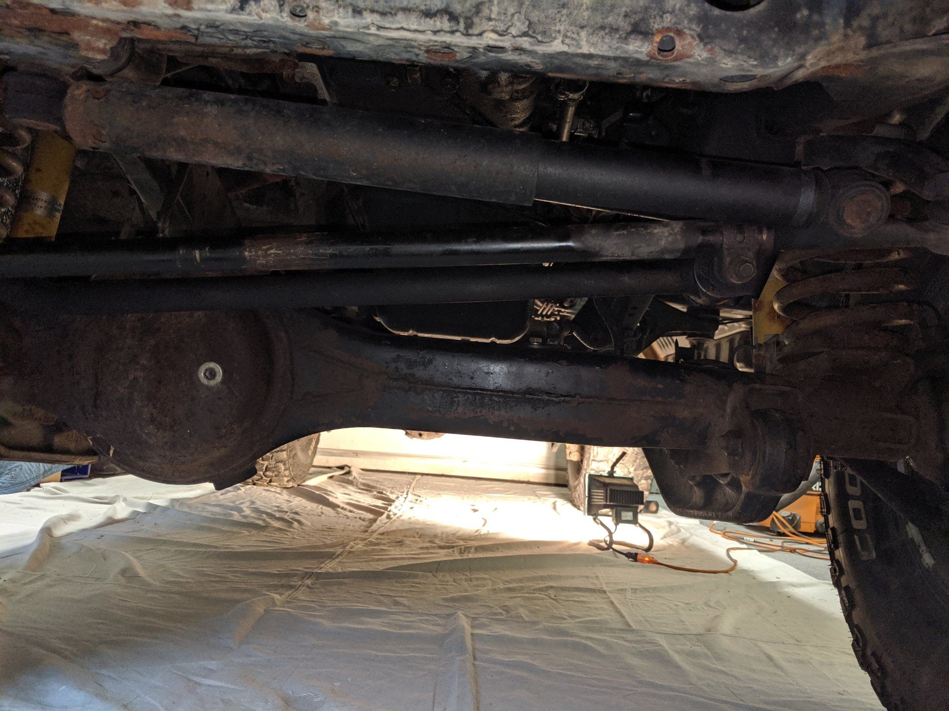

I received my order from Kellsport and sprayed on ~3 quarts of black Woolwax this weekend. We're expecting 10 inches of snow by morning, so the timing was good. I'm looking forward to seeing how it holds up. For now, it just feels good to have the chassis black instead of rust. I'm really impressed with the way they packaged the quarts with the pro gun and hoses. I can imagine it would have been much messier if I had do dump a gallon into a paint sprayer.
Before:
After:
Before:
After:
