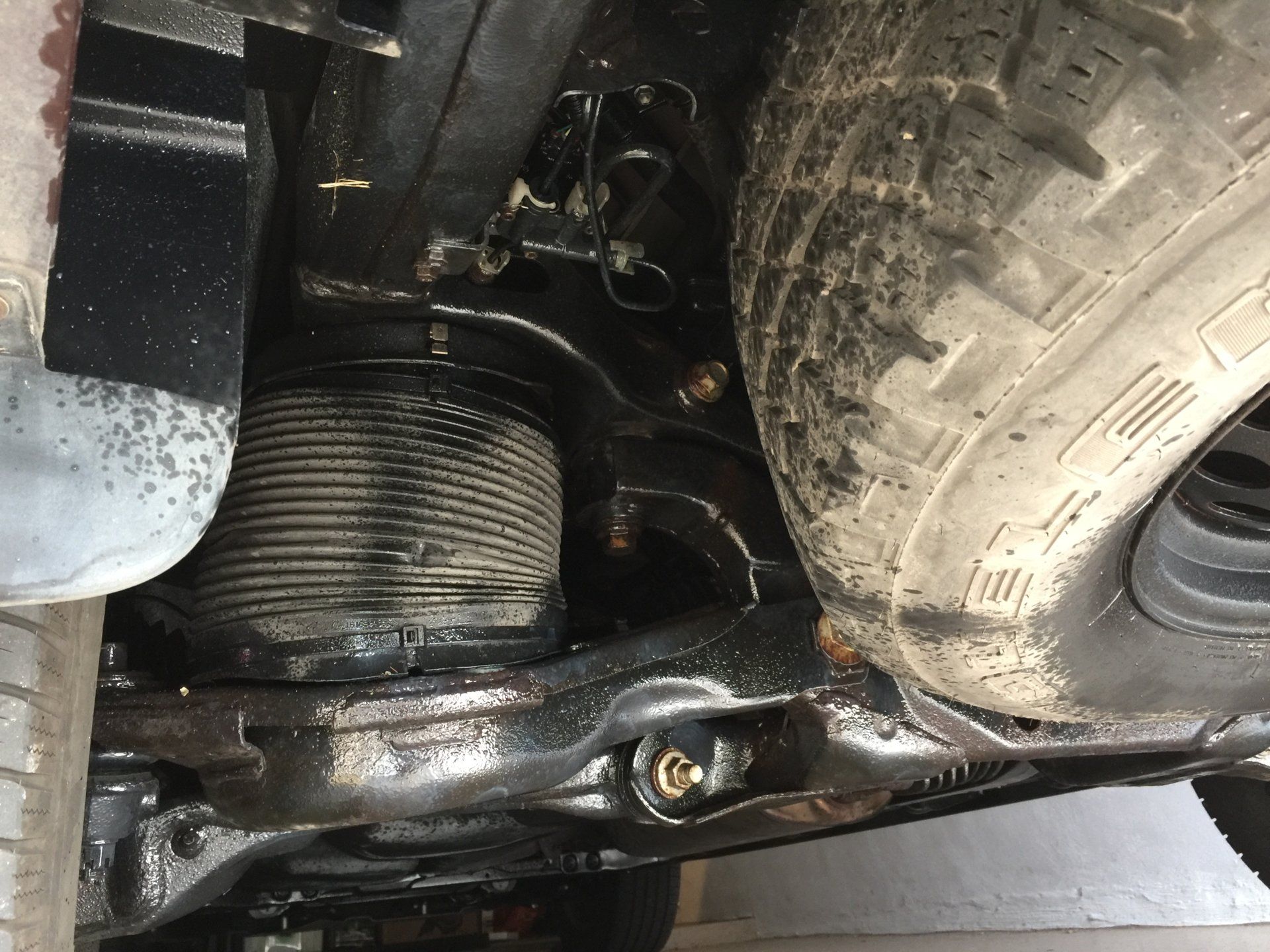

How much drips as you spray? Trying to figure out a location to apply?
Nothing drips. It's the overspray that gets everywhere. I lay out plastic sheets in my driveway and put on a Tyvek suit. Roll it all up and toss in the trash. Done.
Do you mask off your shocks, brakes and drive shafts?
Why? I spray EVERYTHING. My paint gun sprays either a vertical or horizontal fan pattern, depending on my position under the truck and what I want to hit. I start up into the inside of the ARB front bar and end inside the rear bumper. Nothing goes uncoated, including the brake backing plates. The brakes are a bit slippery for the first 1 or 2 pumps.

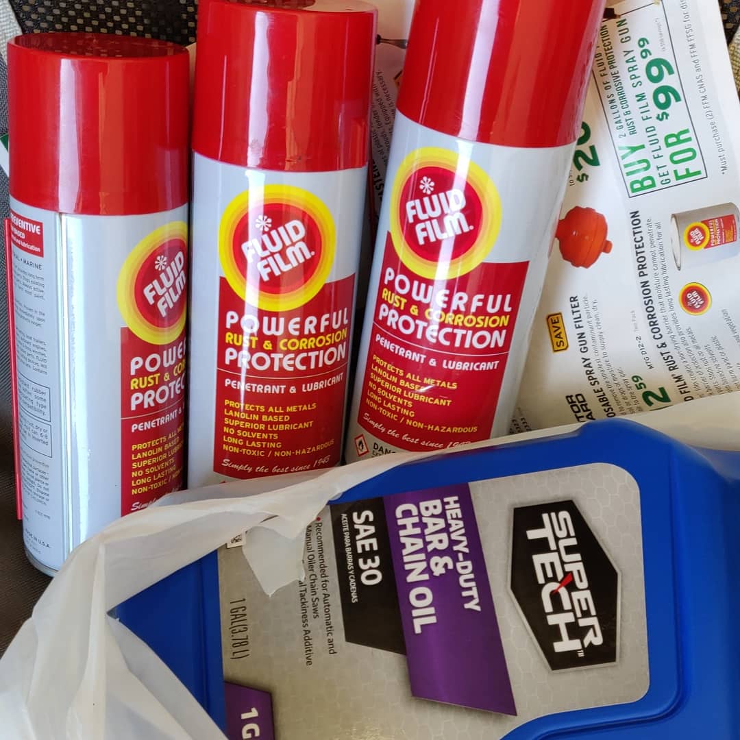

I used both. I thought 1 gallon would be enough for 2 cars (2004 Tundra and my 1997 80) but it was just barely enough for the Tundra. I ordered the Woolwax and had the 80 on the lift so I didn't want to wait for another gallon. I went with Fluid Film, 3 cans and it was just barely enough for the 80. Did the rest with bar and chain oil. The Woolwax didn't spray as good as I thought it would with the professional gun but really both work great and so does using bar and chain oil. All of it is WAY better than just leaving an exposed underside to that shi*ty salt.

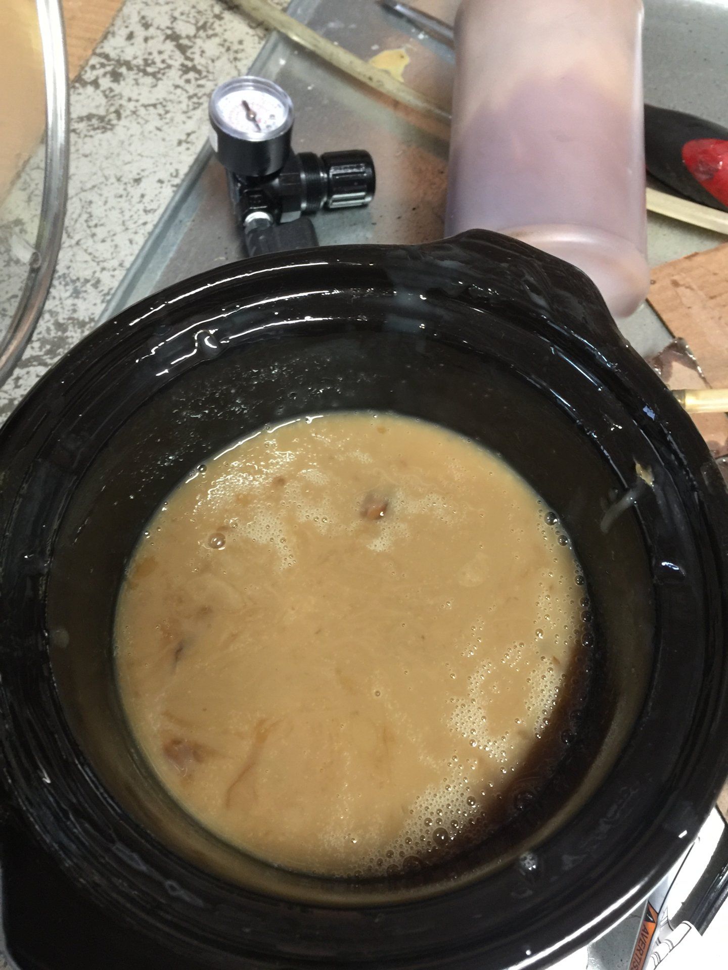

The Woolwax came in and I attempted to apply it today, my overall impression is underwhelming. Outside temp was 50ish today and I used a 2qt Crock Pot to heat it up so it would at least flow. The Kellsport Pro gun with wands didn't work out for me with this product. It would barely spray at any air pressure, I ended up mixing Fluid Film and Woolwax together to get it to spray properly. Kind of a bummer, but maybe this mixture will hold up a little better than regular Fluid Film. I will be sticking with Fluid Film for the future though. Also, the Crock Pot was a great addition at a whopping $8.99 at Target and a soup ladle helped transfer product easily.

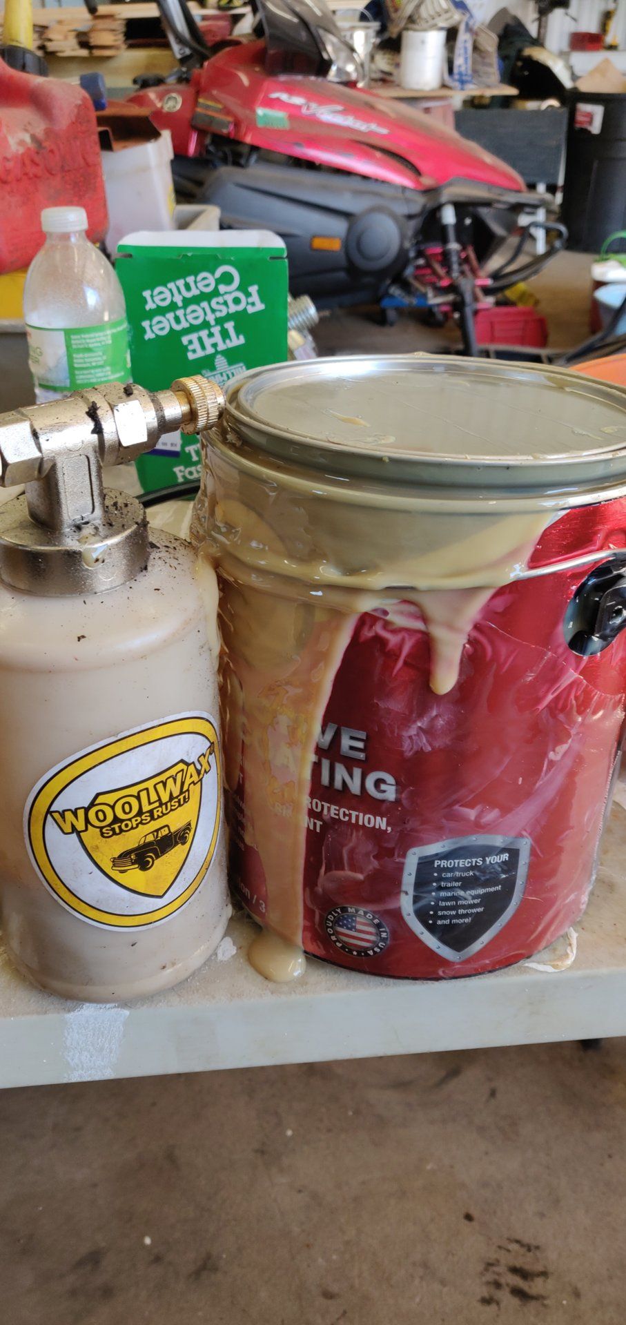

I finally got around to trying the WoolWax. At first I tried using my TP Tools undercoating gun without the wand. It came out way too thick so I switched back to my cheap Harbor Freight air spray gun and that worked really well. I went through about half a gallon and got everything good and coated. Probably have enough left to do my little truck. I did find that heating it up on the stove was key. It is way too thick to even pour out of the can at around 55 degrees outside.
