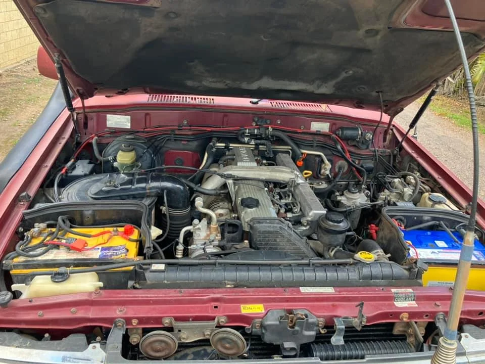

Anyone sourced and fitted a brand new 1hz crate motor recently?
If you're more than kicking tires, you'd have seriously weight the sense in spending $20k on a new 1HZ to put in a rusty 600k km DX Standard 80 that can be replaced for $10k
Agreed, no sense in dropping cash on a new crate 1HZ. Motor is dirt common and goes forever. If you need one, buy a working used one, possibly with a car attached.

1hz + aftermarket turbo vs 1hdt with factory turbo. I guess they are the options. My 80 has been n/a 1hz all it's life and it's 30 yrs old now.
If you truly have $20k to spend, use your 1HZ block and crank, and build up a 1HD-T clone, or 1HD-FT clone, and aftermarket turbo, exhaust, intercooler, injection pump, and smile like an idiot for the rest of your 80's life.
Its like comparing a carby 253ci small block chev to a LS3/LS7/LSX.
The 1HZ biggest downfall is indirect injection... While reliable in stock form, you are very limited in terms of power without risking cracking the head in the precombustion chambers not to mention weaker pistons etc. The factory turbos are direct injection, have oil squirters, better pistons and better flowing heads and are just much more refined and can handle a lot more power.
The 1HZ is great at what it was designed to do... but load an 80 series up with stuff and passengers, big tyres and it just doesn't make enough power to be comfortable.
Now I'm not saying they aren't worth turboing (an after market turbo with a bit of boost does wonders) but in terms of spending like $20k to buy a new 1HZ and after market turbo is just madness. And even doing an engine conversion to a 1HDT/FT/FTE isn't really advised due to the effort and cost to only end up with a base DX cruiser. Honestly much much easier and cheaper in the long run to sell your 80 and buy a factory turbo (plus the resale will be much much better).
