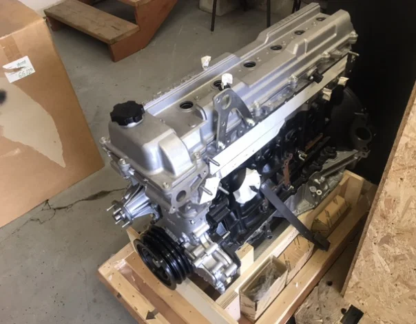

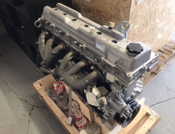

They come with timing case and related gears, water pump, oil cooler and oil cooler cover, head, valve cover and oil pan.
Here is a 1FZFE long block, I out the harmonic balancer and exhaust manifolds on it.

How old is that pic? Too bad Toyota doesn't sell them like that anymore. Do you recall when they stopped selling long blocks?
