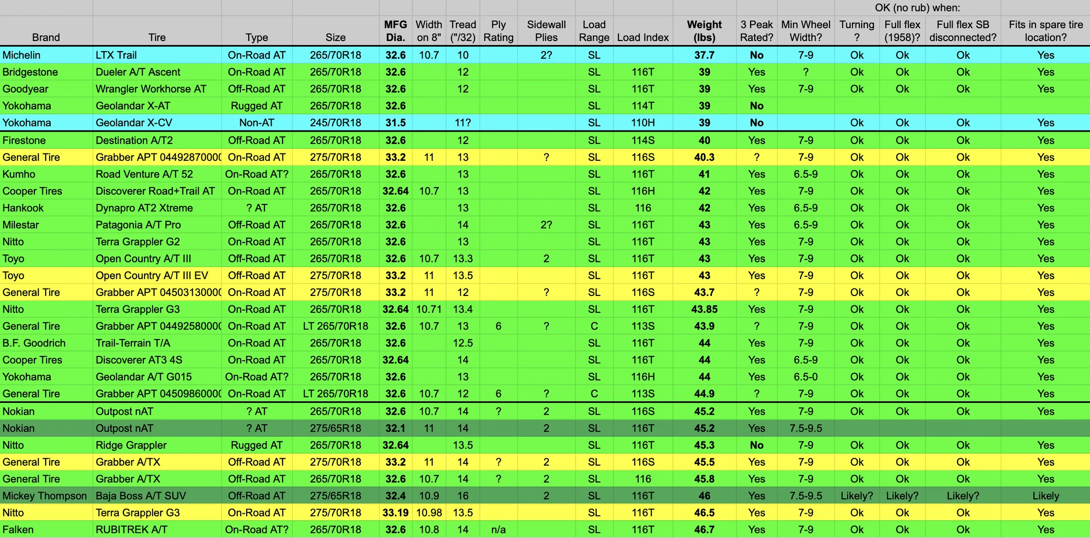

Is anyone running the Toyo Open Country AT3 EV's? Specifically the EV version?
I'm looking to upgrade the 265/70/R18 Michelins that come stock on the '25 Land Cruiser with a set of 275/70/R18's without going overboard on the added weight. According to this chart the stock 265/70/18 Michelins weigh ~38lbs each, the 265/70/18 Nitto Ridge Grappler upgrade option offered by Toyota weigh ~45lbs each. The Toyo AT3 EV seems like the best way to break into the 275/70/18 range and save weight at only 43lbs each (compared to the standard AT3 at 53lbs, the Nitto Ridge at ~59lbs and the KO3 and Wildpeak AT4W at 60lbs each).
