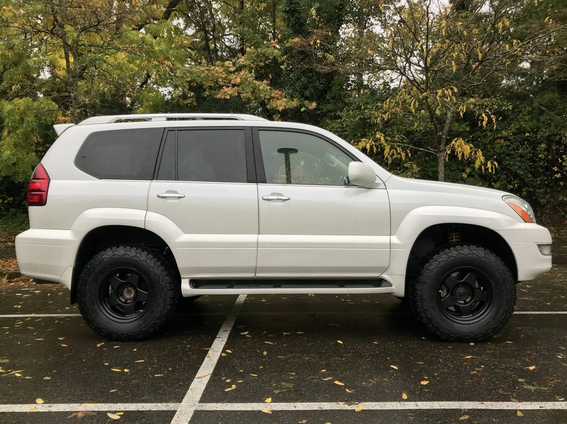

Excited to get the kit on...
Love this kit. You can't beat it for the cost.
I didn't touch the sways.
I put on SPC UCA. They helped the alignment get back to normal.
No diff drop.
Look great @estoddart ! Did you adjust the front height at all or is that how they came ?
