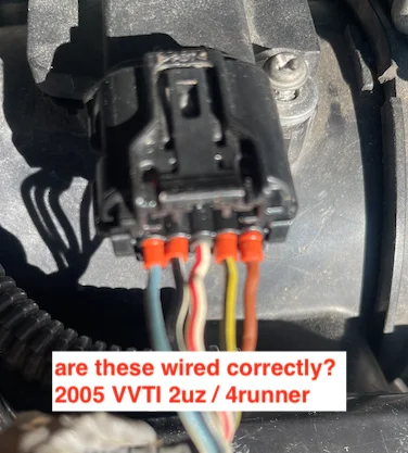

I need help finding the color codes / diagram for my MAF sensor
the vehiclesh has the VVTI v8 engine
I recently accidentally crushed and broke the connector when re-installing the air box without realizing the connector was underneath it because I was working in the dark
I found a replacement connector, but I 'm not sure if I am wiring it correctly, because when I plugged it in, the vehicle starts then dies after 0.5-1 seconds, when I unplugged it from the MAF sensor, the vehicles idles at 2200 rpms or so, and of course threw MAF codes
I tried and couldn't really find much info regarding the color codes on the internet
this picture represents my current wirings
any help would be greatly greatly appreciated
*if someone could post a picture of their MAF connector wiring would be great appreciated
hope everyone have a great 2025

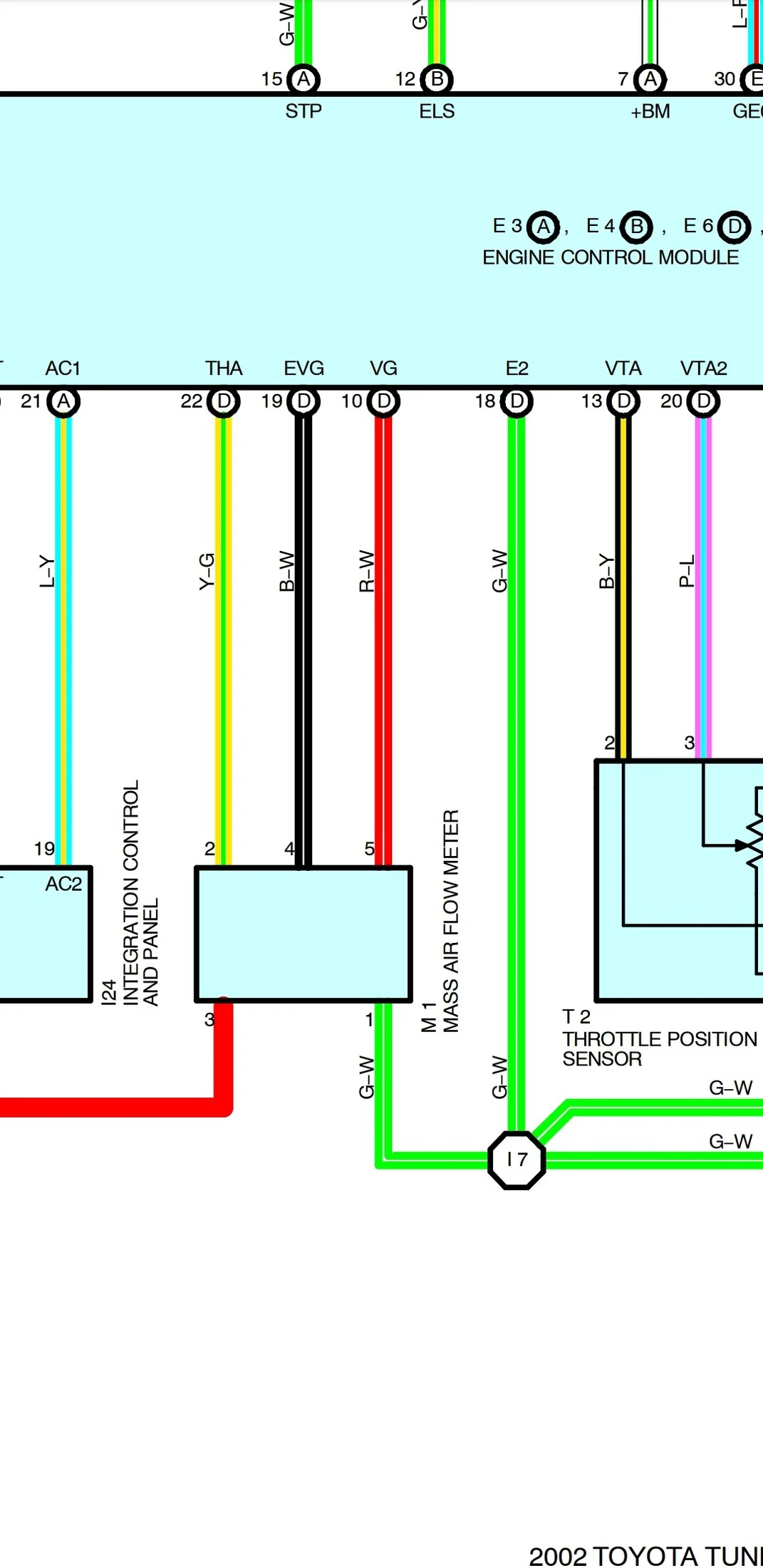

these colors aren't exact but this should get you there. (02 tundra v8)
make sure the terminals aren't stretched or damaged and are fully seated in the connector
