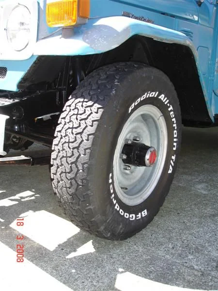

thinking about going 31s on a 7" rim, but I wonder if that is too skinny? Tire would be 235 85R 16 on a 16" wheel. Anyone have a pic?

Here's a photo of a 235/85 R16 tyre on a standard split rim which is just 5 1/2" wide. (Just 5 and a half inches between tyre-bead outer edges.)
:cheers:
PS. From what I remember, the tyre manufacturer doesn't recommend such a skinny rim (as 5 1/2") but I have found this set-up to be fine.
